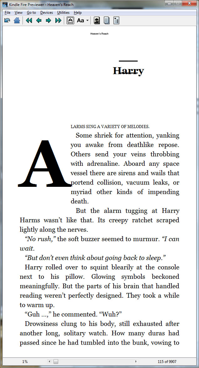

Not sure where to put this question, I was just curious about the KF8 support in Calibre. I took the same ePub file and generated a mobi file once with Kindlegen and once with Calibre. The output is very different. In the Kindlegen version, I can see preserved formatting, whereas in the Calibre version it seems to lose the formatting (see example of the big "A" as the first letter of the text).
I have attached a screenshot to show what I'm talking about. Is there a way I can get Calibre to generate the mobi output to be the same as Kindlegen?

But in my particular example above, why doesn't Calibre keep the formatting as in the ePub? When I look at the ePub file it looks closer to what Kindlegen made. I'm just curious, I thought Calibre was now keeping the advanced text formatting for KF8? I can't seem to get Calibre to ever keep the publisher fonts for a book either, whereas with Kindlegen it seems to work.

The calibre version has no drop-cap at all. In the original ePub verison (Ballantine book from the library), the drop cap is huge as in the kindlegen version. This seems to happen with all Ballatine books I've ever converted from ePub to mobi with calibre. With Kindlegen they always have the drop caps and embedded fonts.
I have the KF8 option turned on in calibre. Not at my computer right now but it's something like "generate both" option you put in calibre.

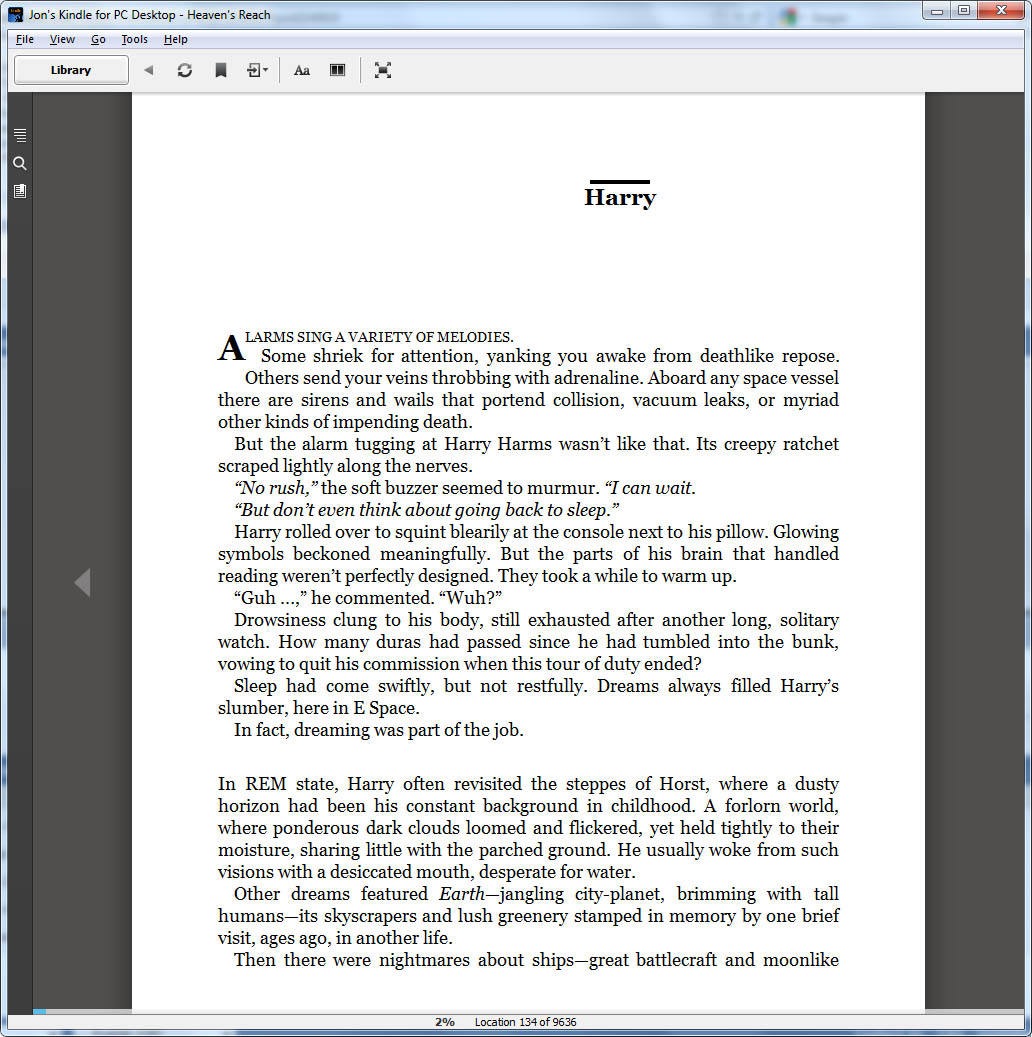

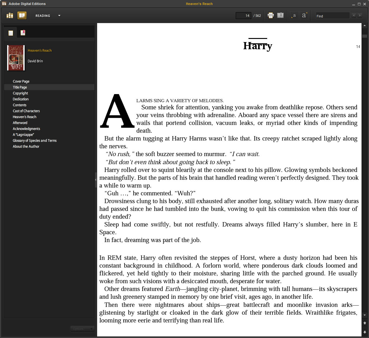

The first one is the ePub in ADE. The second is a Calibre conversion to AZW3 (combination KF8/Mobi) viewed in the latest Kindle for PC. The third is a Kindlegen conversion and viewed in Kindle Previewer.
The Kindlegen version botched the dropcap and while Calibre also did not get it correct, at least it's not silly looking.
And nobody got the 2 horizontal rules (around the title) placed correctly
Kindlegen seems to have font baseline issues but your version is closer to tolerable than the OP's version

And I even double checked with a sample from B&N and the sample also got the two lines wrong. That's just poor eBbook making.
Why is your original ePub screwed up? When I look in Adobe Digital Editions it looks like this:
Also my Kindlegen output has the top and bottom line around Harry in Kindle previewer as well.
The fact that we can get different results off the same ebook sort of scares me.

My experience has been that when Calibre replaces a Dropcap with a Raised Initial, that you're looking at an older mobi conversion, not a KF8.
