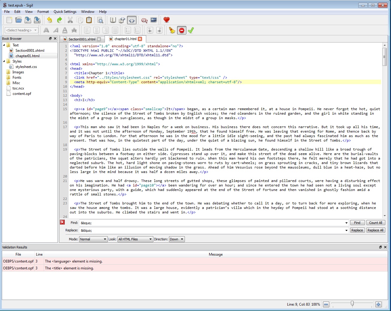

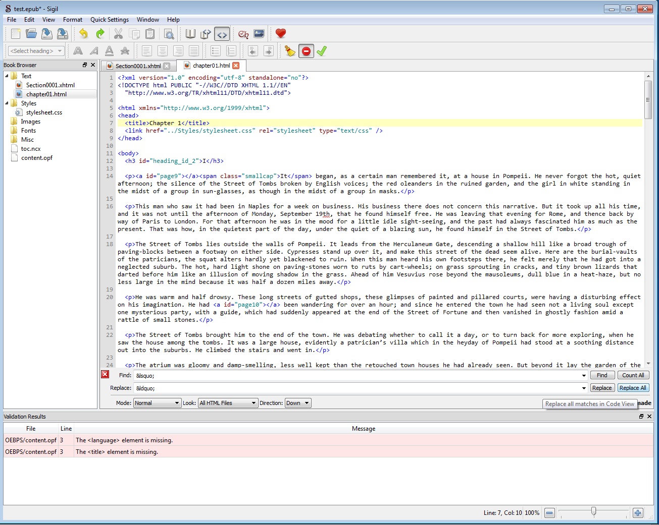

Step1: Have an ordinary epub. Add line
<meta http-equiv="Content-Type" content="application/xhtml+xml; charset=utf-8"/>
in header. Save file
Search and replace for something
Step2: The meta line is gone.
This happens when tidy is turned off (see image) and when the red sign for well-formed-errors is on or off, it does not matter
