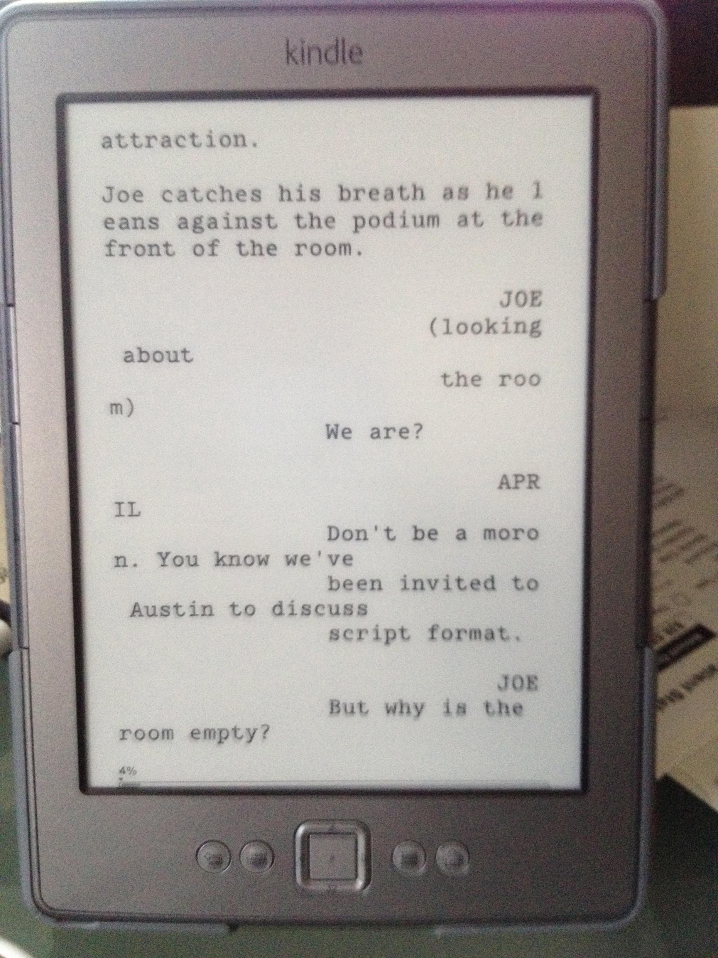

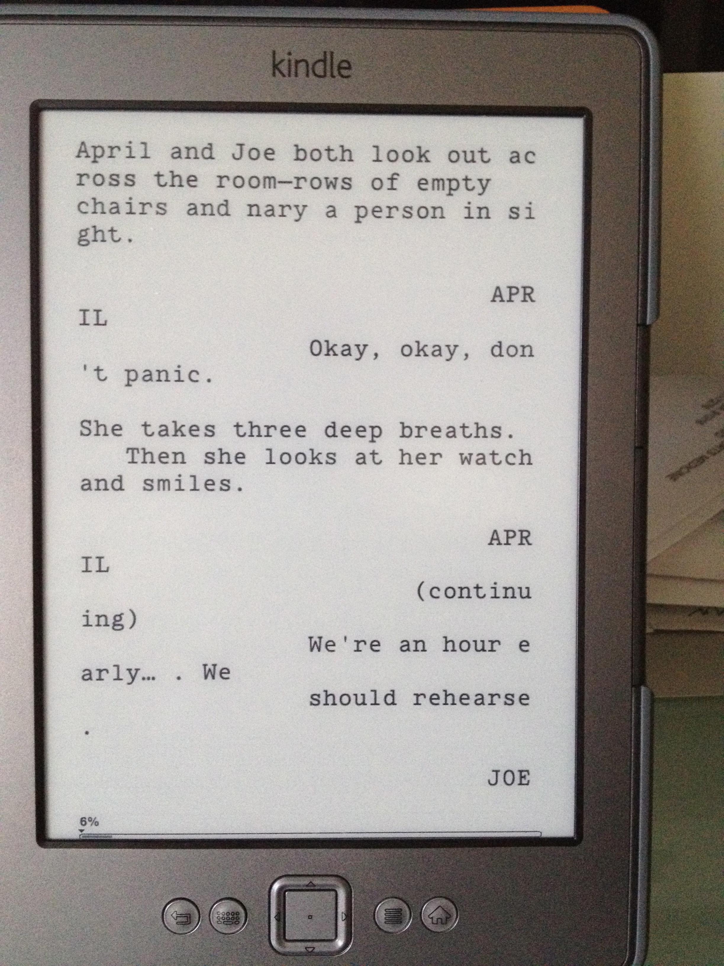

Was hopeful, but...
I've attached jogs of how it looks on kindle. the first two were with no conversion. The last shot, 0266, was with me running it through calibre. Damn, so close!
ID:	86246   Click image for larger version
ID:	86247   Click image for larger version
mcforman is offline   Reply With Quote
