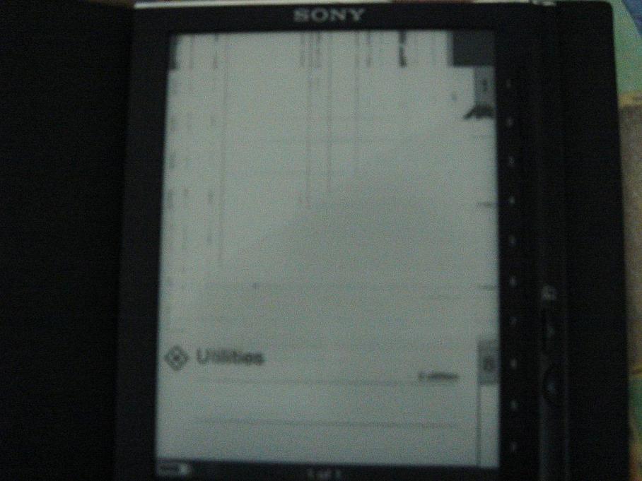

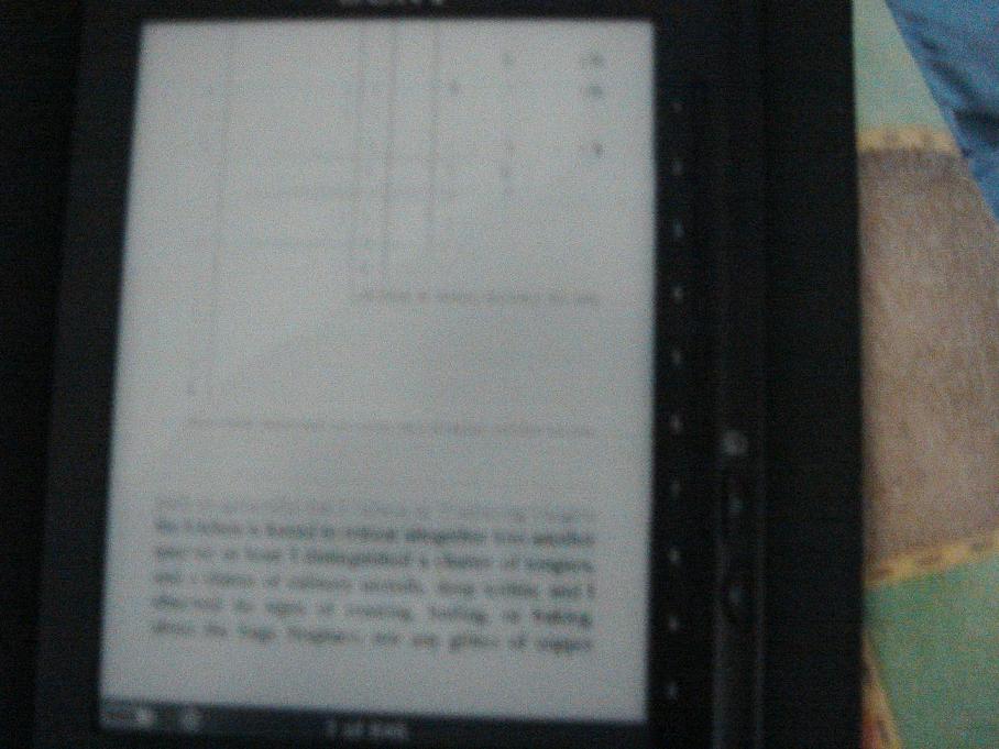

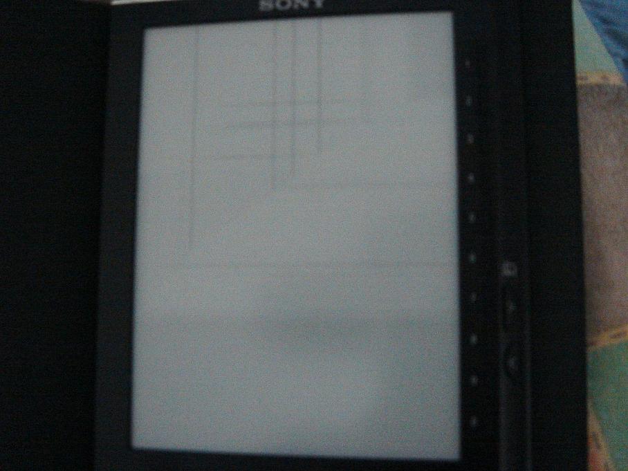

I have the problem with mine. I just got mine on the 21st of November and only with about a week of use I have streaks.
Tried charging it over night but still the same.
I've never took the reader outside of the house and while I was switching pages on Friday night, the reader froze. When I reset, this is what happened...
Sorry for the quality.
Seems more like bad contacts if you didn't throw or knock it

bluesnews - Did you buy it from a local store? If so, you should be able to exchange it without any problem; it's clearly faulty.
donovanh - Sorry to say that I agree with the earlier poster in that yours looks like a fracture in the glass substrate of the screen. A terminal case, I fear. You say that you're in the UK, though; does your house insurance policy cover accidental damage? Most of them do. Getting the cost of the Reader back in return for paying a £50 excess on your policy is probably well worth doing.
