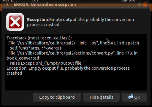

Greeting all folks out here,
I am getting error msg when converting epub files to pdf(attachment).
I use ubuntu 11.04 .
Any help is appreciated .
Thank you.
Name:	Screenshot-ERROR: Unhandled exception.png

Have you validated your EPUB with a tool like Flightcrew or EPUBCheck?

No Success?
Does that mean EPUB check failed?
Calibre may be choking on an invalid EPUB is where my question was heading towards.
With no other info , it is hard to make a guess from some error messages Calibre throws.

Hello dear,
EPUB check success but not the conversion. Is it a bug ?
If it is then how to debug it !
There is an default epub file after installation that contains the help manual, it is also not converting i think it is not invalid.

I have created a debug folder, should i upload it & give you the link so you can analyse what is going on ?

Uninstall your distribution calibre package and install the official calibre binary from calibre-ebook.com
