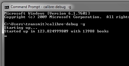

Device: Google Nexus 7 16GB
Have the same issue, 14000 books
start caliber, stare at a white window (not responding txt in win title) for 1:32sec then it starts
Maybe I should do a clean install

weirdly after using cmd to open, it now only takes 19seconds, instead of 1m30. so all's good
EDIT - Hrm, that was only after repeatingly opening Calibre
After restarting Windows, Calibre takes 2 minuets to load
Going to try a clean install of the program and see if that helps
EDIT 2:
Fresh install of Calibre and Yikes now even longer
C:\Users\transmit>calibre-debug -g
Starting up...
Started up in 129.690000057 with 13988 books
Seems like Boxing day is going to be a full re install of windows
Name:	2min startup time.jpg
