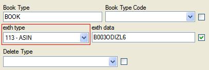

If you want to use an alternative dictionary, you'll need to change its ASIN to B003ODIZL6 so that it matches the NOA dictionary.

Mobi2Mob1's screen capture in the link you sent didn't seem to have a specific field for changing ASIN, or did I just miss it?

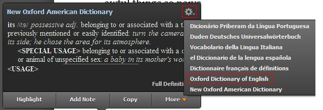

Before you start the hassle of ASIN patching, you might want to download the very latest Kindle for Android app, which offers both the US and UK versions of the Oxford dictionary.
You can switch between them by touching the cogwheel icon in the upper right corner. (If you select a dictionary that is not installed, the app will download it for you. )
You need to select ASIN from the exth type drop-down list box.
