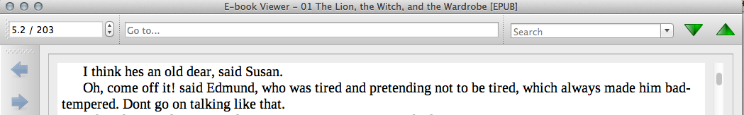

I did a screen grab of two sentences in Inspect Mode and as they appear in the viewer. The first sentence has no indication of punctuation in the inspector and none appears in the viewer; in the second, all the correct punctuation is in place in the inspector but in the viewer, no punctuation.
Not a great way to spend your Sunday, but much appreciated.
Wow!
as you surmised, #1 does not contain punctuation
#2. Those are straight (double) quotes, right?
They have to be some odd-alternate character that only looks like a quote
