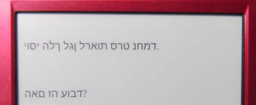

I was able to save the TXT with UTF-8 encoding such that Hebrew characters were visible on my PC. However, once transferred to the T1 none of the 7 font options would display the TXT correctly.
The T1 does have a built-in Hebrew font (which isn't selectable using the T1 font selection options) so I converted the TXT to EPUB using Calibre and added some css code to
  • reference the T1's Hebrew font
    @font-face {font-family: serif, sans-serif, monospace;  src: url(res:///ebook/fonts/DroidSansHebrew.ttf)}
  • display right-to-left
    body {direction: rtl}
The results were mixed. The epub displays OK (I think) on the PC in the Calibre Viewer. I've attached the epub so you can check for yourself.
Unfortunately, once transferred to the T1 the standard epub application displays the Hebrew characters but unfortunately it displays them left-to-right not right-to-left (see attached). Not having any experience of RTL languages I don't know whether there is a trick to getting this to work properly.

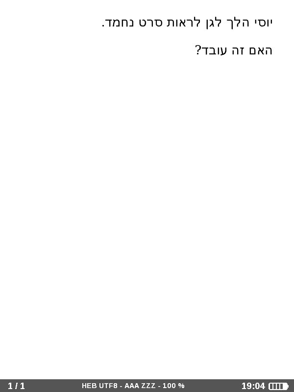

seabee's link stated that the PocketBook supports Hebrew correctly. As I have a PocketBook 360 I tried both the TXT and the EPUB. I can confirm that both appear to work correctly as long as you use the PB's FBReader application rather than its Adobe reader application. No hacking was required. See attached screencap of the TXT file.
