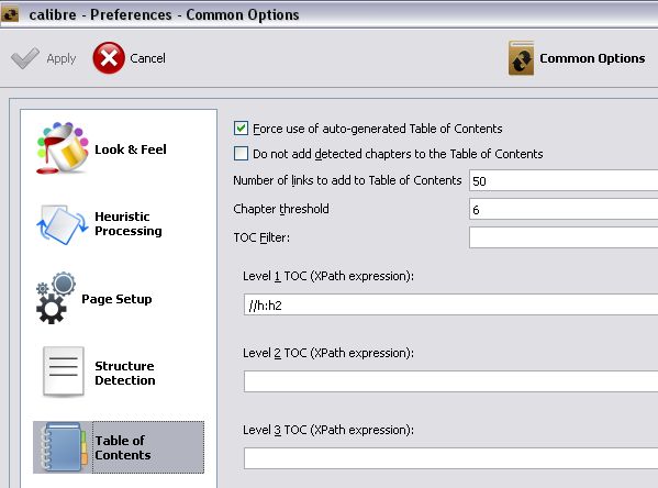

I have read your post several times and now it seems to me, that you have a ToC, but it is without links to the following chapters of your book. Calibre needs links to analyze and build the structure of the eBook.
1. Check the links in your toc.html (either to separate files or to anchors)
2. 'Force use of auto-generated Table of Contents'. See 'preferences.jpg' below.
3. Start building your eBook with double click on your toc.html file.
It will be part of the book. If you click on another file you will only get the metadata toc of Calibre.
If
- the toc.html has no links,
- or you don't have a toc.html file,
- or the toc.html file is listed in the folder with your files at the wrong place, i.e. before the file you click on, then your eBook will consist of that file only.
One of these settings may be the reason for the result when clicking on '1.1 Thing at the Start' in your eBook.
Calibre works well with <h2> as toc.txt (html code) and toc2.jpg (Calibre viewer) show.
The chapter titles in Calibre's metadata toc are the <h2> chapter headlines of the html files (see 10.txt).

There was a misunderstanding when you said in your first post, that you had exported the toc as an html file.
And you didn't say that you work on mobi. I prefer epub because I can tweak it afterwards. I don't know how to do it with mobi.
This time I have made all files one and tried it without any links or anchors and it works too.
The problem seems to be that in the preferences there is an interdependency between:
a) Table of contents / 'Force use of auto-generated Table of contents'
and
b) Mobi Output / 'Do not add Table of Contents to book' as default.
You chose MOBI at the upper right corner.
The last must be inactivated and then you get
1. the auto-generated Table of Contents of Calibre and
2. a Table of Contents added at the end of the book with links to the chapters.
It looks horrible but at least it works.
