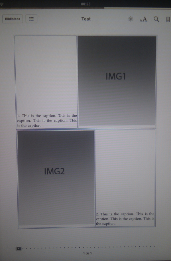

I have to show 2 images with their captions.
One image has to be aligned to the right with his caption at his left side and vertically aligned to the bottom line of the image.
The second image has to be aligned to the left with the caption at his right side also vertically aligned to the bottom line of the image.
I tried to make it with 2 tables, and the result is OK in Sigil and iBooks, but in ADE the second table displays the caption out of limits.
In the images I've uploaded you can see that in ADE the first table displays the two cells OK, but in the second table something goes wrong and cells aren't displayed as I want.
Can someone open my eyes? Is there a better way for doing it?
I've also uploaded the epub.
Thanks.

Did you notice that the borders around Img2 don't look the same as around img1? When I am more awake I will change the size classes to have different border styles to see more clearly what is happening. It looks like the 100% image width over-rode the 55% cell width.
You may have an example of one (more?) of the ADE bugs noted in the sticky thread here.
Yes. That's the reason I used borders for the cells, to see what's wrong.
But this doesn't happen in the first table with the image in the right cell. Also, if I define the second table as the first one (with the image at the right side) it's displayed OK.

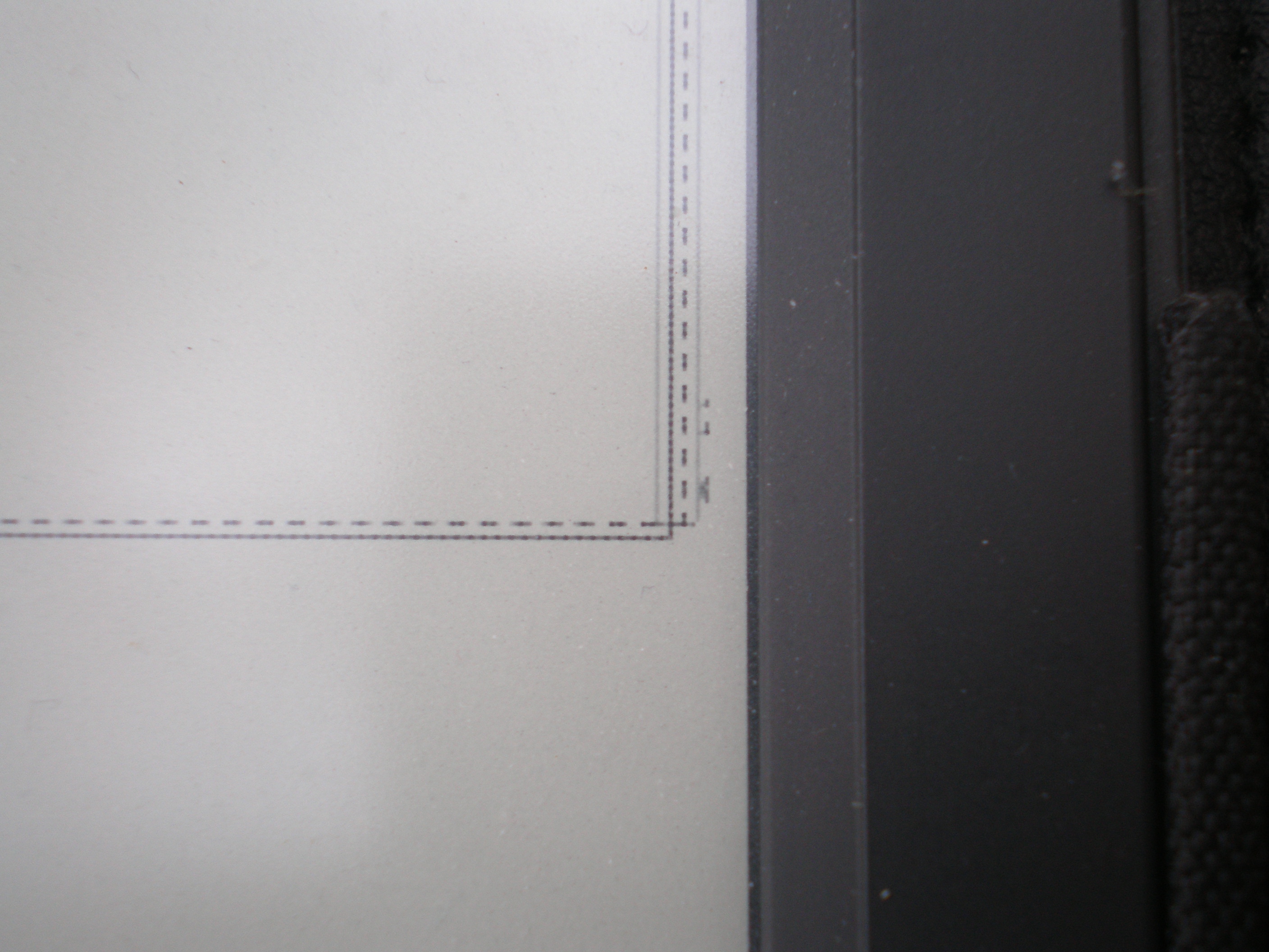

After changing the border styles in your test, I am convinced you have found a bug in the ADE engine. Note that in the attached picture the solid lines look slightly dotted - this is due to dithering to try to make the line look blue. When I changed the colour to #000000 it looks exactly right - the lines, not where they are.
In the picture you can see that the first data cell border (dashed) extends beyond the table border, and the second cell borders (dotted) start within the table and extend beyond the table and beyond the first cell border.
To me, that's a bug, not a feature.
It gets really weird if you remove the "width=100%" from the image spec, by the way --- another bug, I think.
Edit: Oh, RE no width: I think the size of the image is controlling the size of the its cell, leaving little left for the other cell.
Basically, there is an interaction in the handling of tables and images, which is handled poorly.
