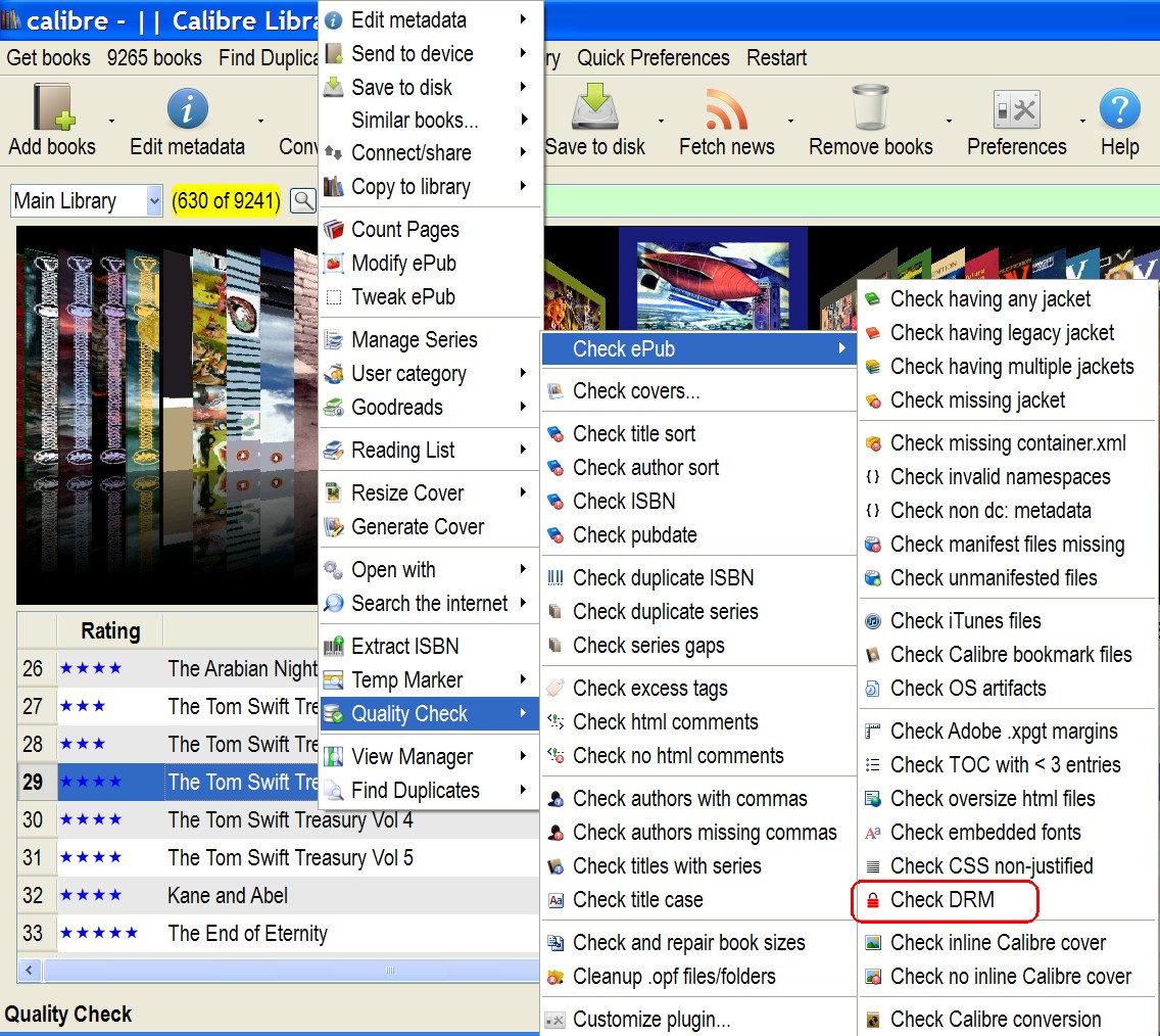

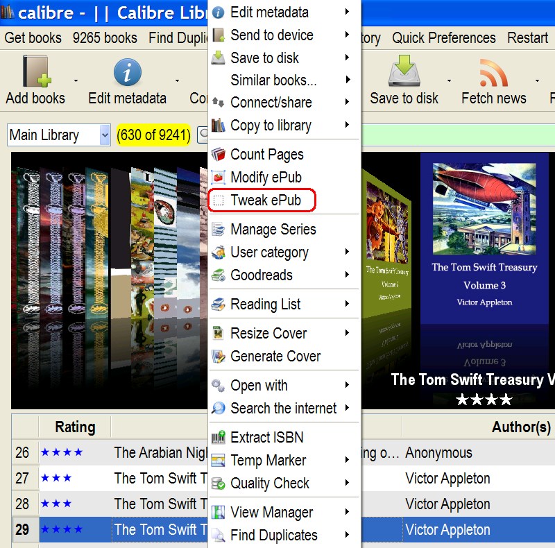

Both of the following suggestions (by unboggling and by taustin) have merit but wallcraft's suggestion of using calibre's viewer gives you a nice error specifically saying the book is infected with DRM, see attached. Alternatively you can quickly check an entire library of ePubs using the Quality Check plugin, see attached.

I'm sure unzipping it can tell you if it is infected with DRM, but renaming it to zip isn't needed there is a Tweak Epub (see attached) feature built into calibre that will let you explode the book and allow you to examine the contents.
