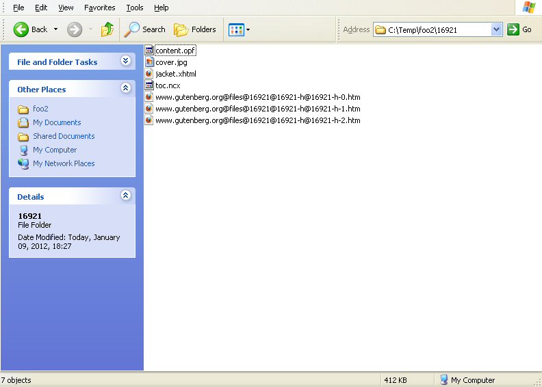

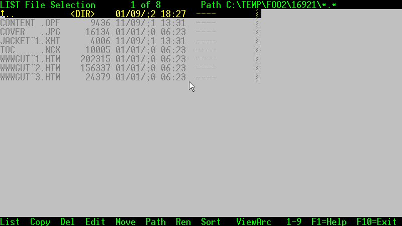

The file name in then Limited to 4 characters and a 3 char Extension for that to work.
This is a Windows file system issue, Not Sigil
Attached is how the filesystem shows the names in native 8.3 mode and in windows
ID:	81025   Click image for larger version
