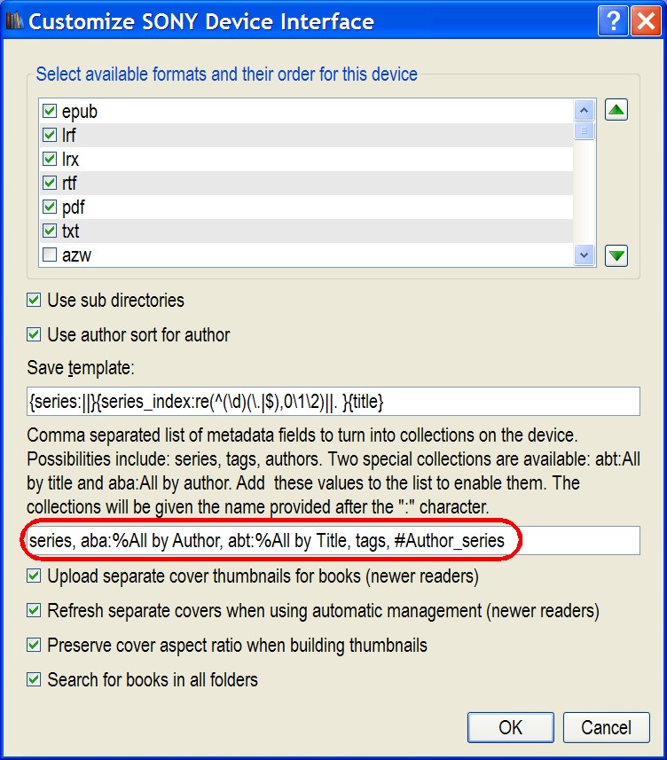

The idea of reading books by an author, that are not in a series, in some sort of magical Published order is very strange to me. But if this is what you want you can create a series type custom column, call it Author_series, Then put your desired series info in this column
Michael Connelly [1]
Michael Connelly [2]
Michael Connelly [3]
etc.
Or using the year.month as the series info
Michael Connelly [1988.01]
Michael Connelly [1988.10]
Michael Connelly [1990.03]
etc.
Now go to Preferences - Plugins - Device interface plugin - Sony and customize the plugin and add your new column to the line that creates collections (see attached) on your reader. Now when you send books to your reader Collections for both standard series and your custom series will be added with the books in the order you set them to in the library.

I made a custom column for Author. It is a series like column. So I change the device plug in to NOT create collections from the built in Author column.
THis way I can number each book in any order I want, and have them show up under Author in that order.
Some authors I do it in published order. Others (like Micahel Connelly) I put them in series order, and put the series in some order. So I have all the Harry Bosch in order, then all the Lincoln Lawyer ...
Although, I am thinking about changing and having the series books only show up under their series, and then put only those books that are stand along under the Author name.
