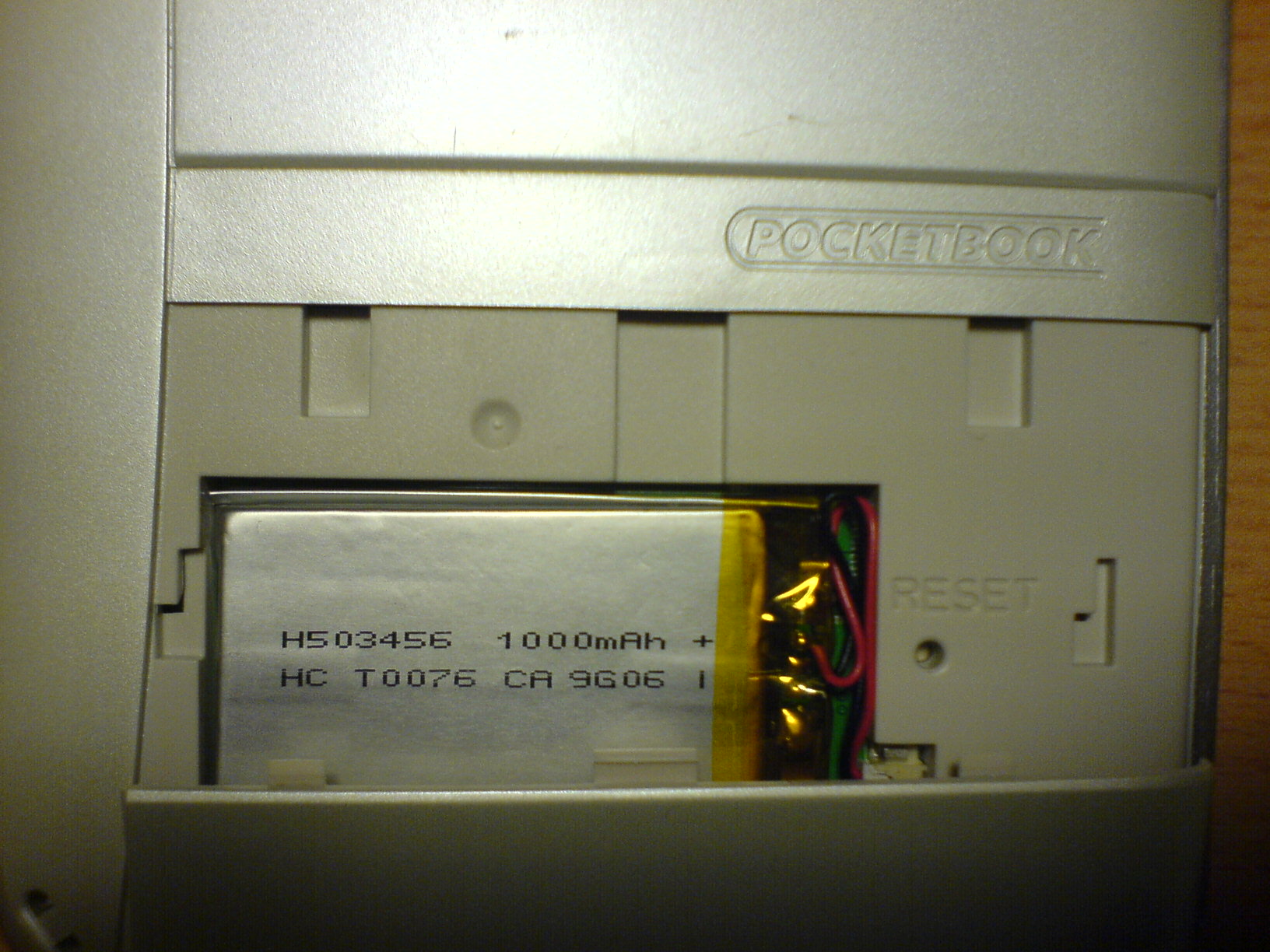

Photo and link to the German-language FAQ, unfortunately there is no translation into English.
The battery compartment on the back of the device can be opened by one below the pocketbook lettering on the back light exerts pressure, and then gently push the lid down!
https://www.mobileread.com/forums/showthread.php?t=64634

The back side of the PB360 has got two covers - upper and lower. The lower one is the one we're looking for to open.
Put your two thumbs on the lower cover and pull it a little bit towards yourself, it slides open and then you can take the cover off.
The reset button is in a pinhole to the right. Don't forget to connect your PB to the power source (PS or outlet) before re-setting.
