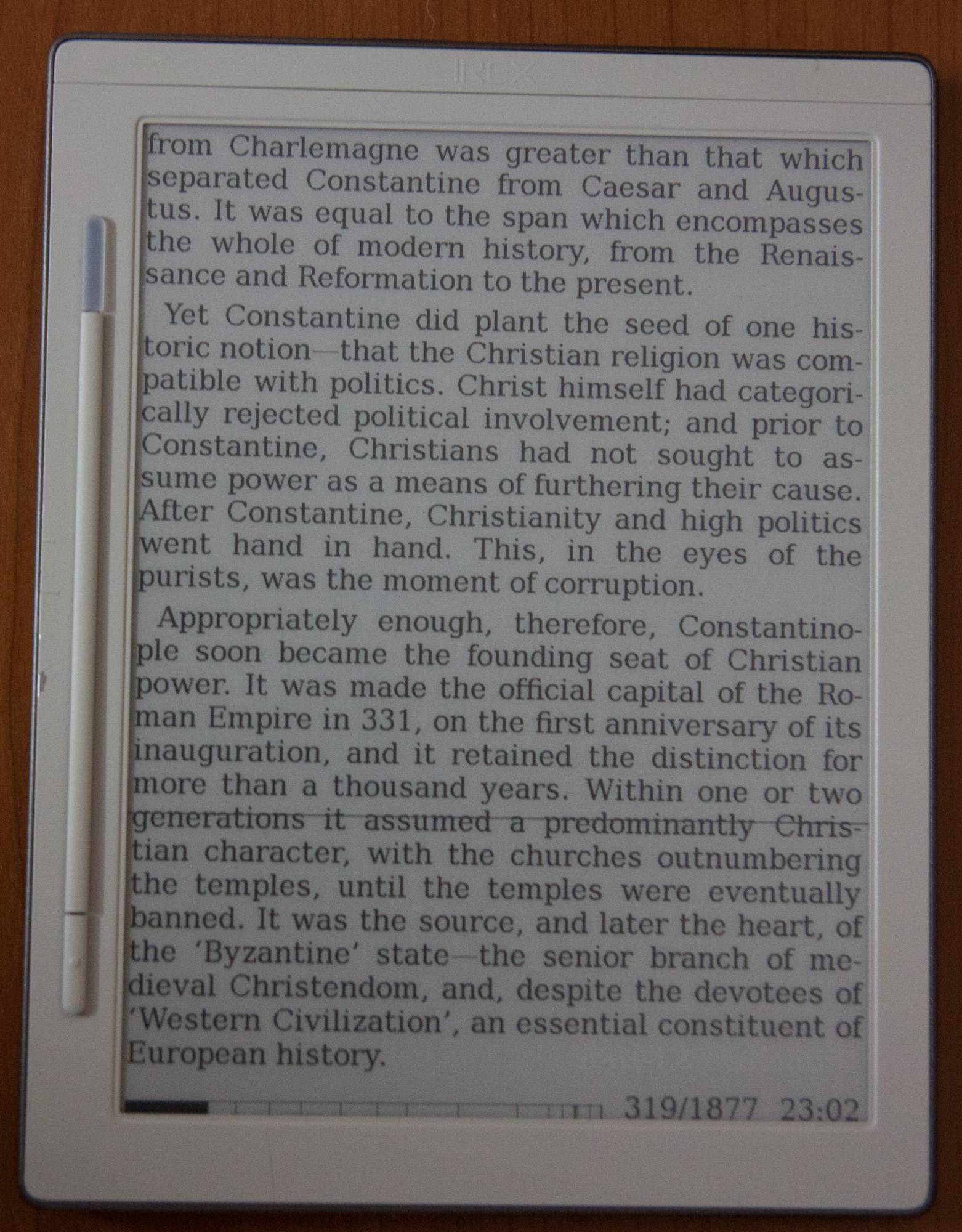

This evening I was reading and when I turned the page my reader suddenly froze. A black 1px line appeared at 3/4 of the screen. I tried to reset it, the green led when off like usual and it went dead. I removed the battery and put it again, and now the orange led is on when connected to the computer or wall charger, but after I try to reset it, the led goes off even if plugged.
My computer does not recognize the device when connected to USB and when I reset it I hear some kind of sound, but only when the device is plugged in.
The device had DR800+ firmware (previous to last version, 3 I think) and I was using the latest version of FBReader.
What should I do? Leave the device as it is until battery drains off or try to charge it? Anything that I can do from computer (I am using Windows, but I could probably boot a Linux LiveCD).
I suppose since iRex is dead, IRX cannot fix my device if it's really broken.

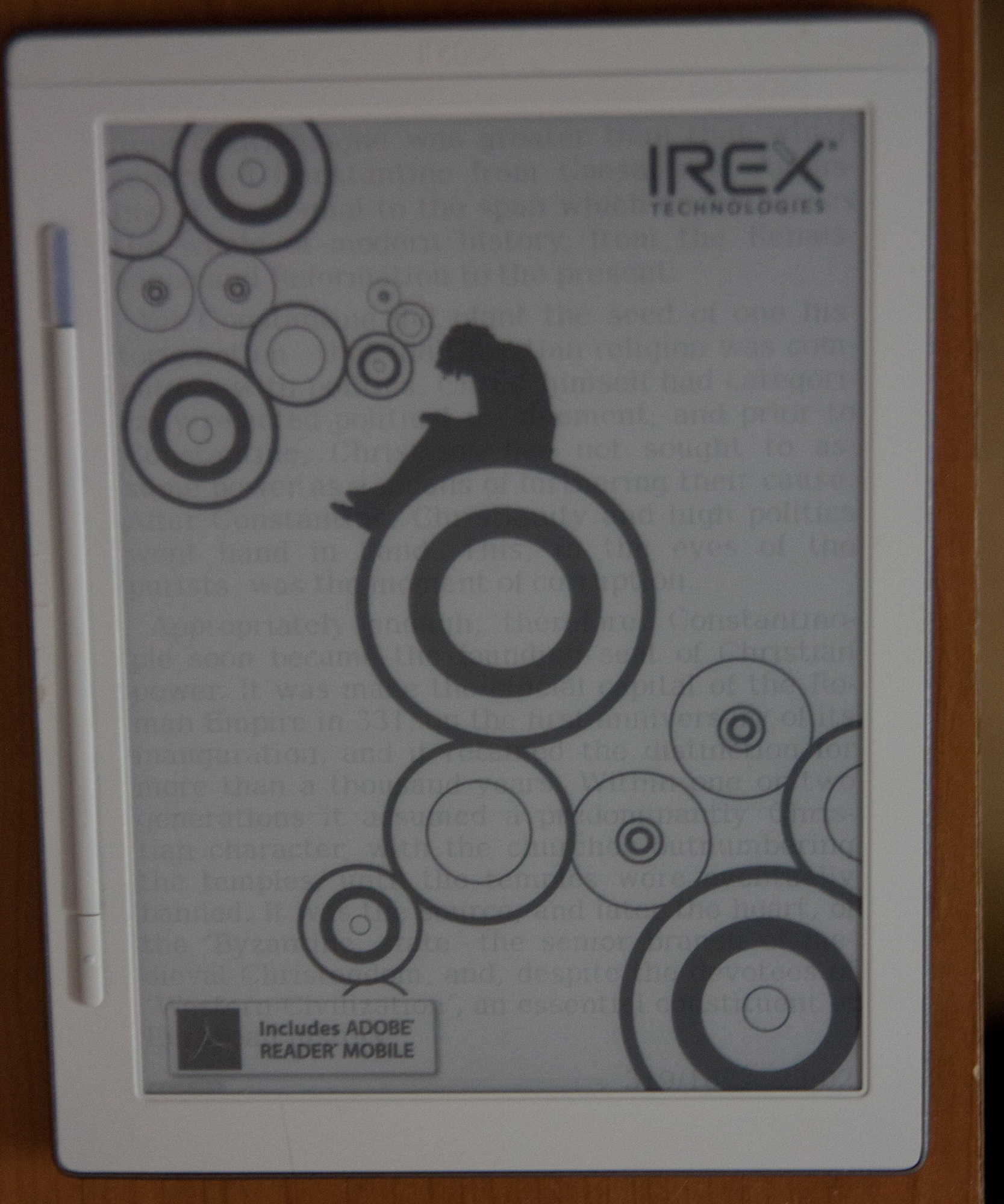

Later edit: I removed battery and SD card and I managed to do a half-reboot. Now there's the image of the guy reading with ghosting from the page the device was frozen to. Still does not want to boot.
Later later edit: 2 unrelated events: I formatted the SD card and put the RC3 firmware on it. Now, after reset, the orange led is on, but still no change on screen and it's still dead if not plugged into pc or wall socket. Guy reading with ghosting of last page before the freeze is still there, the six dots in the middle dit not appear yet (I'll put some pictures tomorrow).

I left it without battery for few hours and put a formatted card with RC3 firmware. After I plugged it to wall charger (without battery), I managed to reset it, it detected new firmware and started installing. At one moment the led started flashing from blue to red, then it became green for a while and then became stuck in blue/red, as in video below. What is not noticeable in the video below is that the boot animation became darker than usual and that the loading animation was still on:
Here are some pictures of how it looked after crash and after first failed reboot:

With battery it's dead. If I leave it without battery for a while, it tries to boot. Last time it went normal boot sequence (green led flashing), the led turned blue and flashed once, resumed to green flashing and then turned in to blue and kept flashing, until finally went dead. Boot animation was displayed until it froze. I will leave it without battery for a while and try to film it. It seems that something hardware is seriously wrong (probably some flash memory), but the screen is ok. Are there any hopes it can be fixed?
