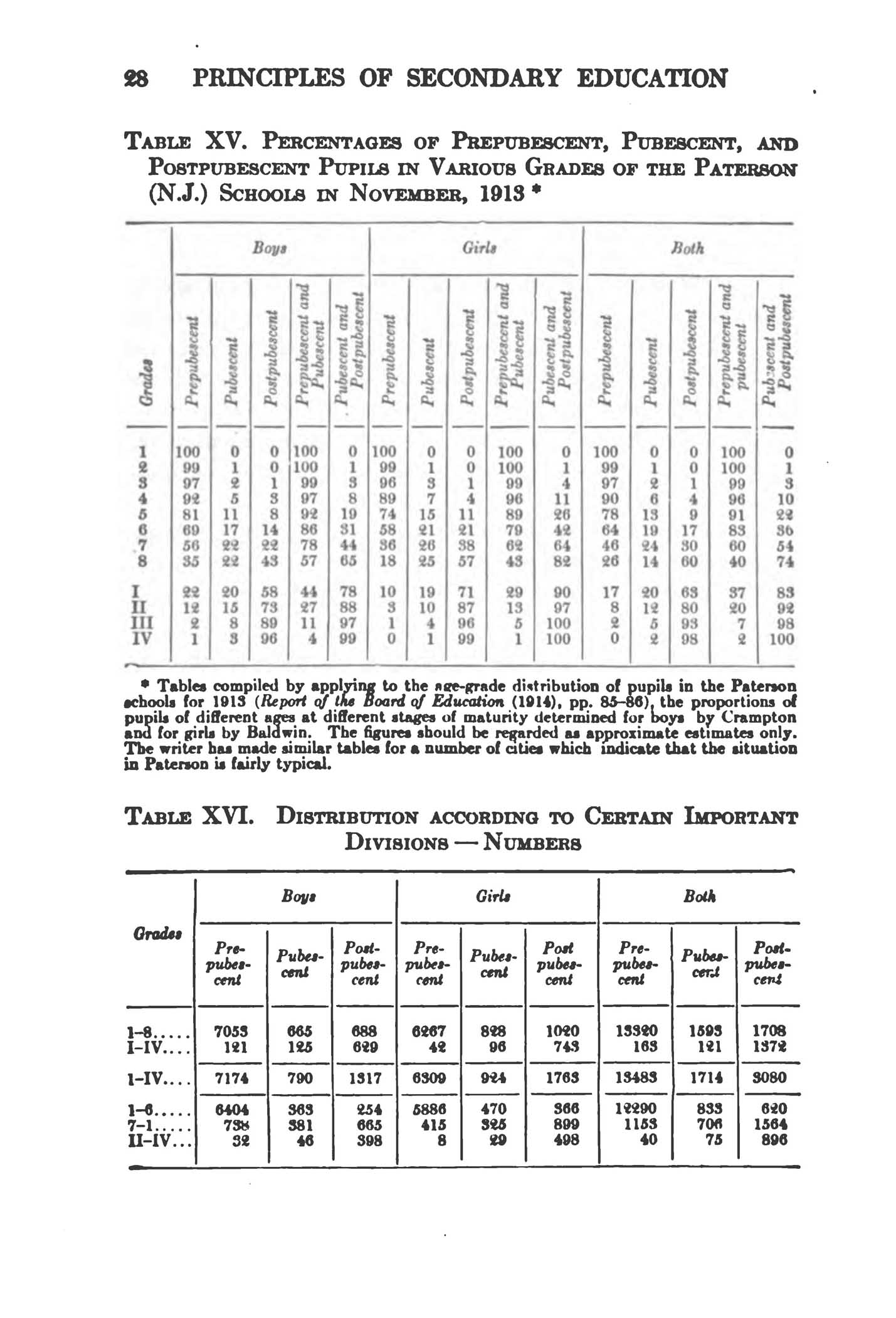

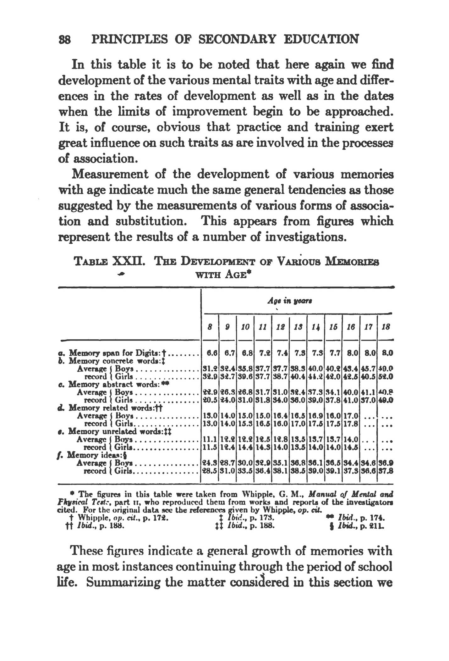

The current book has only a few tables, and relatively simple ones. And the one chart that needs to be a picture, is about as simple as a bell curve--as long as the basic text on the sides is readable, it'll be fine.
The next book has nightmarish tables, and lots of them; I'm considering whether to redesign some of them entirely & split them into multiple parts so they'll fit on ereader pages more easily.

I think a redesign to simpler tables would be a good idea. Dense numbers can be difficult to read and use.

I could imagine you getting by with the first table by breaking it up into three separate tables. One for boys another for girls and then both. However that second table needs to have the LH column condensed somehow.
I've been adding tables into the chapter files quickly and easily by creating them in WORD. Saving them to HTML then cut and paste them appropriately. Maybe Open Office is as useful but I haven't tried it.
I've been formatting the tables with CSS as needed. The headers only display once in everything I've tested them on. PC emulators and iPad apps.
