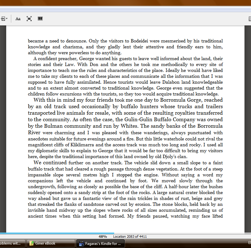

And, finally, how do I correct such text/style errors like the one in the attachment?

As for the TOC, that is normal. You can have an additional page with a TOC in your ePUB. You have to create that file and the anchor links to the corresponding headers. The layout of the TOC-page could be anything you like, any style you would like.
I am afraid you need to create that by hand.
The style errors in your display seems to be wrong usage of styles. Go to the codeview in Sigil and see if a different style is used. If so, correct it to the correct style.
That looks like a possible 'Scene break' done with a 'First Paragraph' type treatment. (personally, I don't like this particular (size only) treatment. YMMV)

I'm guessing Sigil is not recognizing your chapter headers for its TOC because ID4 is not using <hx> tags, but rather something like <p class="heading-1-with-overrides-2"> (Hopefully all chapter headers of a given level will use the same class)
To fix this, globally replace the <p class="whatever"> tags with <h2 class="whatever"> tags (not forgetting the closing tag!) and then in the CSS, change the p.whatever { ... } element to h2.whatever { ...}
Now Sigil will find your chapter headers and create the toc.ncx.
Now Sigil will find your chapter headers and create the toc.ncx.[/QUOTE]

I would suggest care using this method. Let Sigil do a find and count for you (find and replace box) and if you have more hits than you have chapters, either do chapter at a time, a replace one at a time or try inserting <h3 title="Chapter 1"></h3> at the beginning of each chapter. If you use the search and replace method Sigil will put the closing </hx> in for you when you go from CV to BV (code view to book view).
