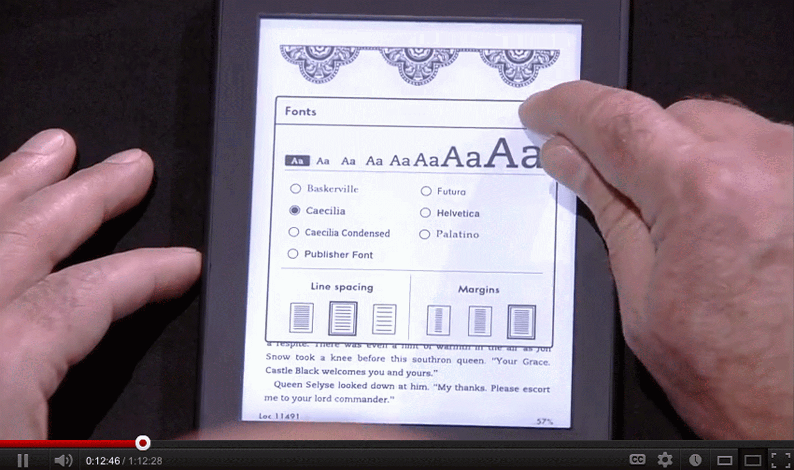

I recall a KPW screenshot showing the font dialog (here) with more fonts to choose from than on KT, and listed by columns.
If the method for adding custom fonts still works the same, I guess that selecting them won't be easy. There's not a lot of space in the font dialog for them (provided that they get listed).
