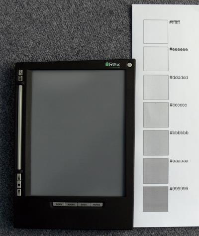

i took a few pictures of my display.
is it broken or can this be solved with some 'software' tweaks.
on the first pic you can see three different brightness levels of the screen (device has just been turned off). this is not a shadow falling on the screen!
it gets darker from the upper left to the lower right.
in the third picture you can see how dark it is when reading. the bar with the chapter number used to be a mid gray against the 'white' paper. now it's almost indistinguishable from the background.
maybe one of the irex guys can comment on this, so i don't have to post this on both forums.
thanks
ps: here are links to bigger pics (1800x2100px, 500k) -> pic1, pic2, pic3

yeah, that's what i thought for a few weeks, too. but for me it really got harder and harder to read over time. then i noticed that a gray bar with chapter numbers (see post above for pic) had almost the same color as the 'white background' and the different colored areas of the screen became more and more obvious.
i've printed out the gray scale from the pics above and compared it for another two weeks. the screen's darkest area shifted almost two levels to the darker grays.
printing out the 16 level gray scale is quite useful. you can track your screen change and compare it to other iliads.

we should ask someone with a new/unbroken iliad for the gray value of his display. then anyone can compare it to their own to check.
