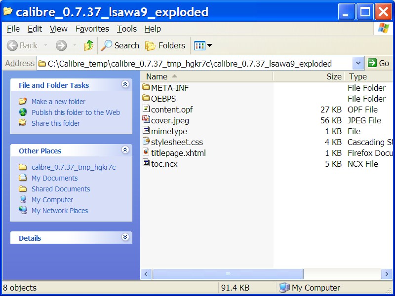

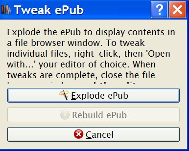

Now I know what you are talking about. The reason for my confusion is because "exploding the epub" the way toddos used it means something very specific.
Originally Posted by toddos View Post
use the "Tweak Epub" option to explode the epub
It is the process of unzipping the ePub file and exposing the files that are internal to the epub.
You can do this by right clicking on any ePub book in calibre's library view and selecting tweak epub (see attached). Once you select tweak ePub you get the chance to "Explode ePub" (see attached). Then you end up with a folder with the contents of the ePub (see attached).
ID:	64212   Click image for larger version
