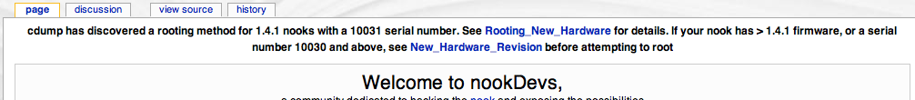

Originally Posted by spec View Post
Mind sharing how do you know that?
If you look at the top of the page, this is how he knows that.
that message hasnt been updated in ages. From what i understand nooks that come from store with 1.5 no longer have the vulnerability allowing to root via router/dns trick that worked with 1.4.1, 1.4.2, 1.4.3:
