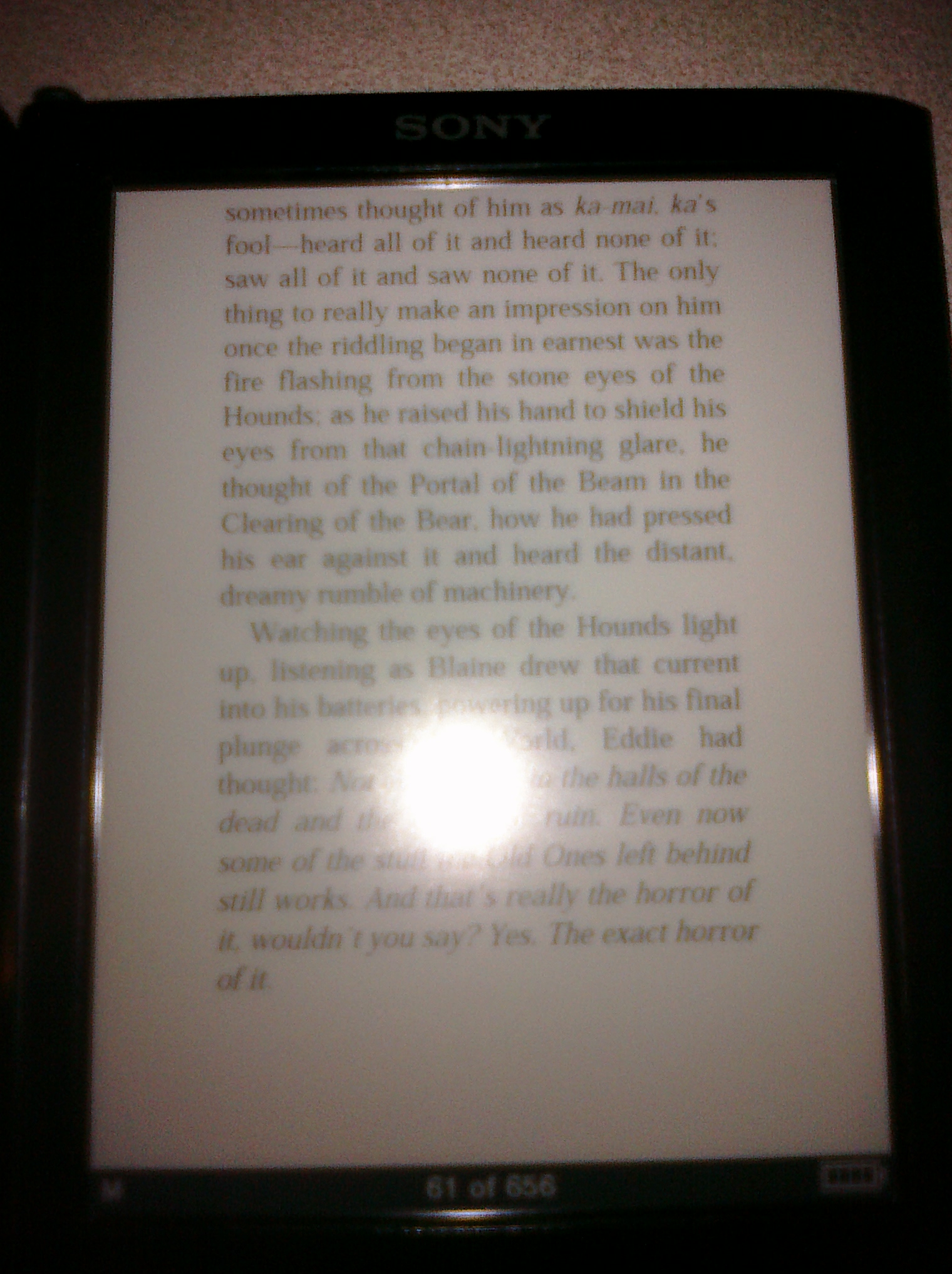

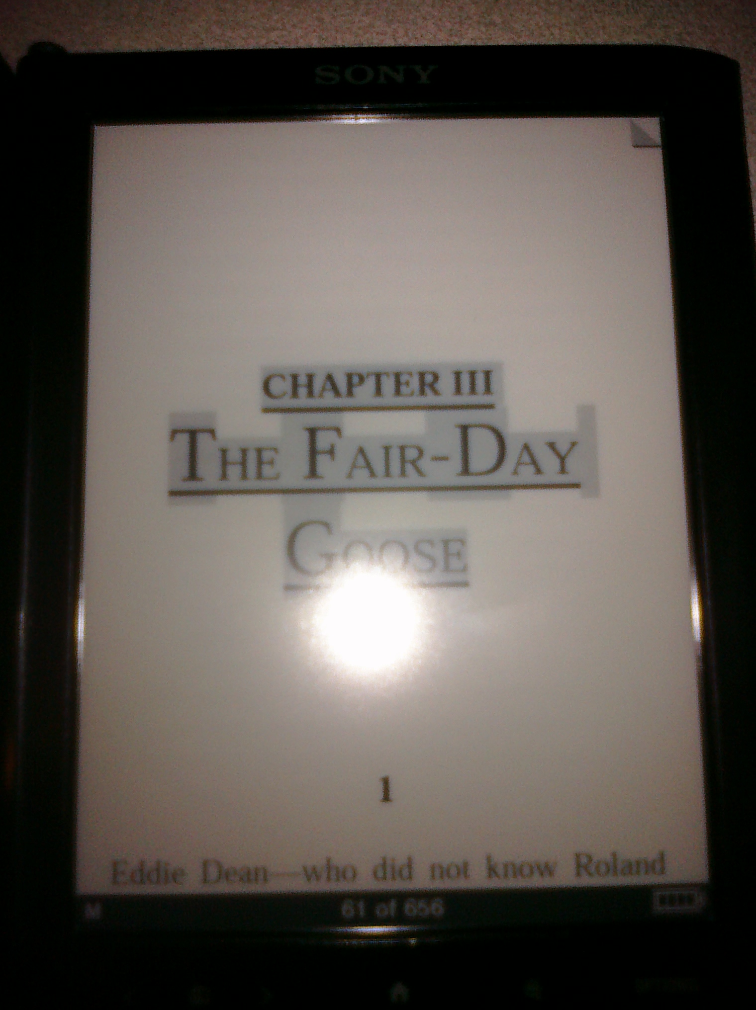

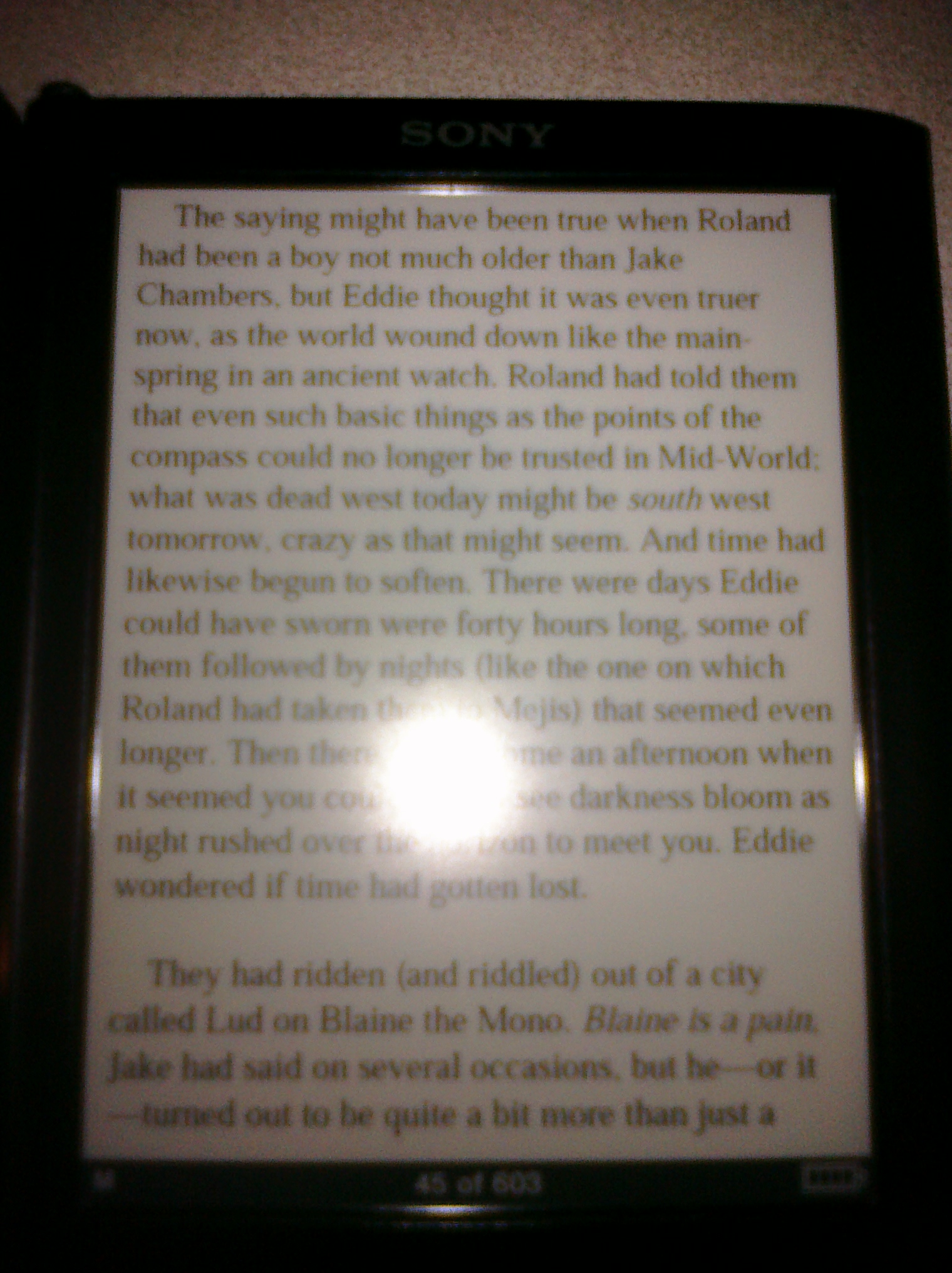

I looked through posts and found some vague references to fixing formatting on Kobo books, every single one I've purchased from Kobo has really small font with large columns, and no ideal size font (difference between medium and large is ridiculous and medium is about where small is on other books).
I have emailed their support and sent them screen shots from books with no resolution yet. They seem to be cheaper than Sony's store on some books and they are always running some kind of special, which I like. However, the formatting is a deal breaker for me. Has anyone found a definite way to fix these? I removed the CSS on one just playing around and it didn't seem to make a difference. I even have noticed that sometimes on title pages of chapters the font size and margin is perfect.
I attached the screen shots I have comparing the pages of books I have tried, any help is appreciated.
Thanks!

For books that have larger than normal margins, you can try to play around with the margin cut settings. This has worked for me on a few books where the next font size seemed too big for my tastes.
Another alternative would be to remove the DRM from the book then convert it from ePub to ePub using Calibre. This way you can set your own margins and specify your own default font size.
If removing the CSS doesn't work and neither does margin-cut, that sometimes means it's the XPGT file within the EPUB that's causing the problematic margins, and which can usually be safely removed. I use Calibre to tweak and explode the offending EPUB, then delete the XPGT file usually found inside the OEBPS folder. Look for content.opf, open it in a text editor, do a search the line containing reference to .XPGT, and you can delete that line safely. It does sound laborious at first, but once you've got the hang of it, it takes several seconds.
Of course, this will possibly remove the margin for everything inside the EPUB, but it's not something I care about much.

It is not the fault of Kobo. It is the fault of the publisher who released the eBook with that formatting.
That said, what I do is strip the DRM and fix up the CSS. It doesn't usually take long at all to do so and if the ePub does not have embedded fonts, I specify the fonts I use that are on my Sony. Removing the CSS won't do squat to fix things. You have to edit the CSS to fix things.
Most ePub have margins (I want no margins), large indents, line spaces that do not belong, and sometimes small fonts by default. This is what I have to clean up. It's fairly easy if you know CSS.
