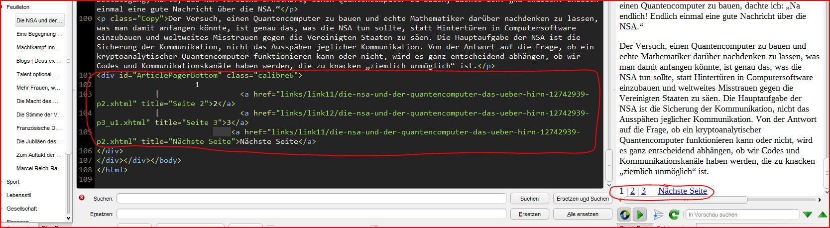

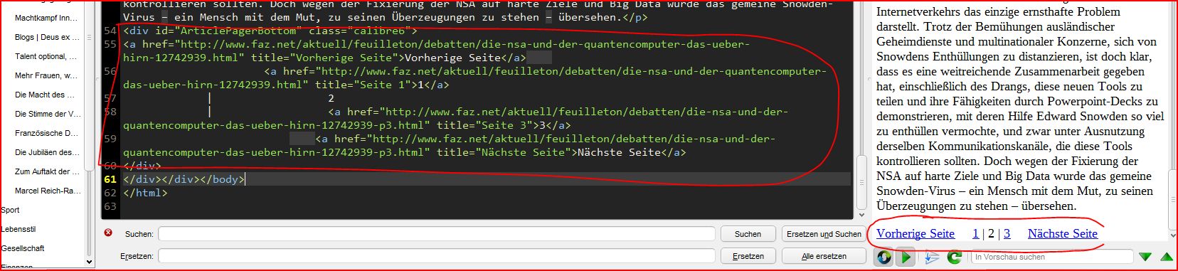

I made just a test in the recipe. If there is a multipage, the jump from page one to page two works perfect with the internal page link. But on page two and following pages, the links refers to the original internet pages instead of the internal pages.
Picture one show the links for page one, picture 2 shows the links on top of page two and picture 2 shows the bottom links for page two. Same issue for next pages.
Is there a solution to fix this?

No, it has always been present. I didn't bother to remove the next page sections, you should do that via postprocess_html, something like this
def postprocess_html(self, soup, first_fetch):
for div in soup.findAll(id='next_page_whatever'):
div.extract()
return soup
