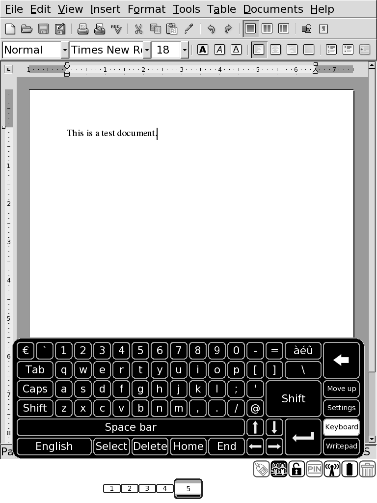

I'm attaching my installer for Abiword. For those who aren't familiar with it. Abiword is a document editor similar to Microsoft Word.
Because of no internal refreshes, and relying completely on the hacked libX11, I'm going to call this a beta release. It's usable, but if you want to edit long documents reliably, this port may not be far enough along.
This includes the registry modifications, so that you can open the following extensions directly from the contentlister.
