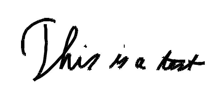

Better way of merging Scribbles?
I've got my iRex 1000S since yesterday. Overall, I like it - but I am rather disappointed in how the iRex Companion Software merges Scribbles with PDFs. The lines become very blocky - see the close-up of my attachment.
Does anyone know of a way of merging the Scribbles so that the lines will become smoother? For the record, I am using Windows NT (though I have installed cygwin, if that helps).

I did a simular test with Xournal, which seems to be generating 'better' PDF-code which more smooth line-endings. See attached PDF.
How is the 'linux-merger-app' performing?

Originally Posted by Jürgen Hubert View Post
When you choose the "Annotate PDF" function and try to open a PDF, where can you find the folder where all your "normal" documents are located?
Unfortunately Xournal can not annotate existing PDF files on the DR. The implementation of the functionality requires an external pdf to bitmap tool. The bitmaps are then imported as 'background'. Since I think that the 'build-in' pdf-viewer/annotator does a much better job, I did not put any effort in porting that part of xournal. My point was that other programs do a better job, so the limitation is not in the pdf-format, but the generated pdf-document.
Back to your question: Xournal shows the folder in which it was started by default. In the top-left corner of the file-dialog, you see 3 icons. In the first one you recognise an arrow, it for going one folder up. The 2nd bring you to the root of the internal flash (you would normally not want to save/load anything from here. The 3rd is the interesting one, it brings you to the root of the SD-card.
