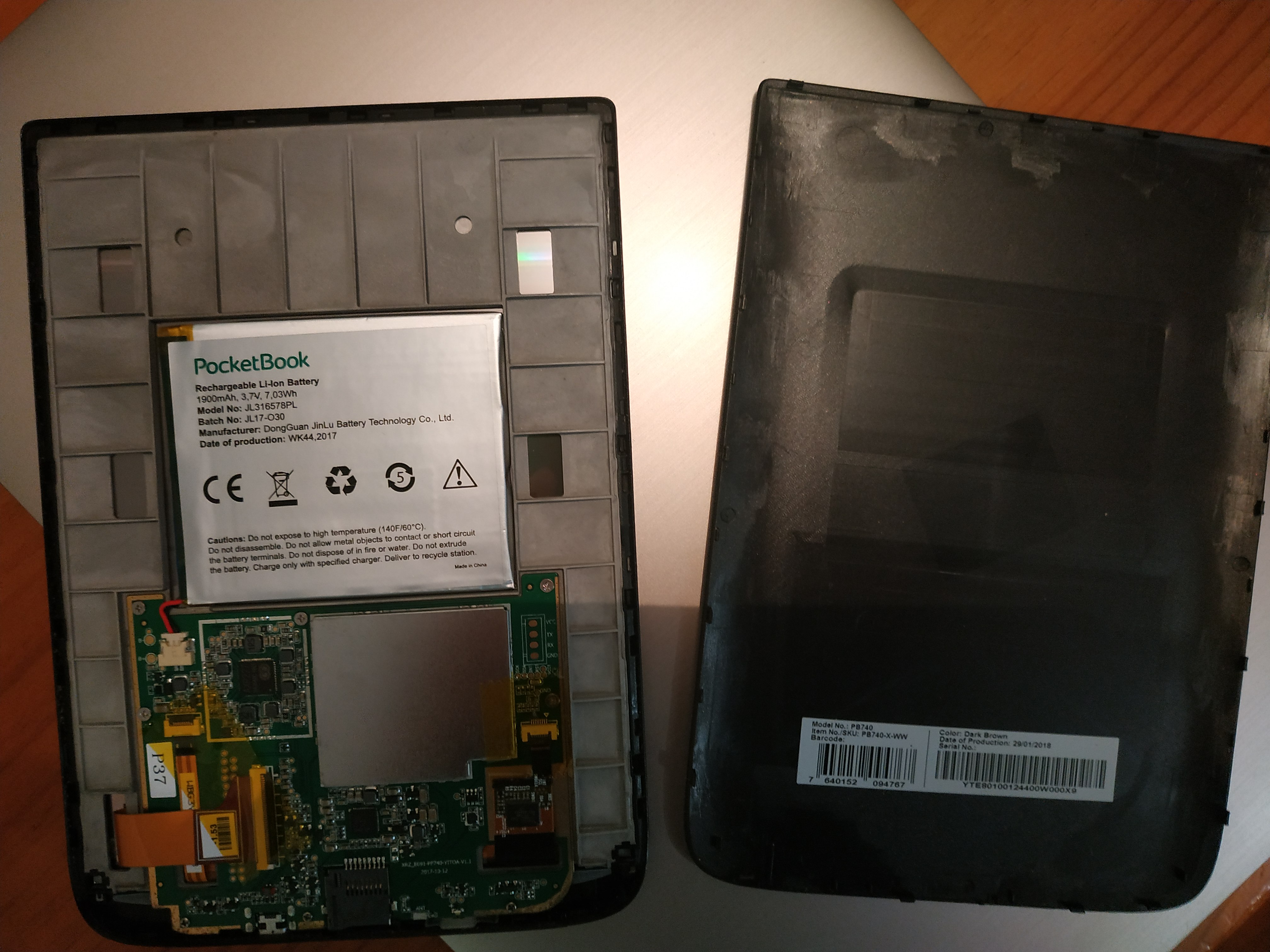

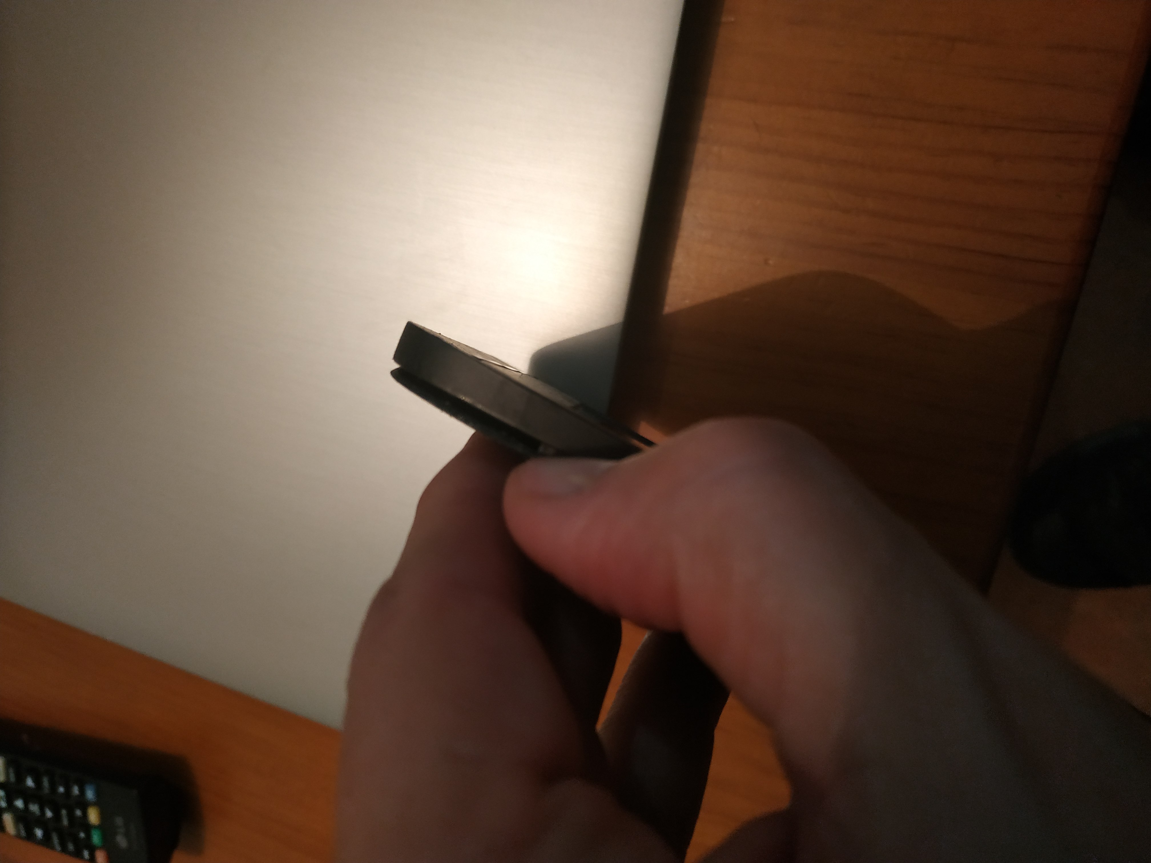

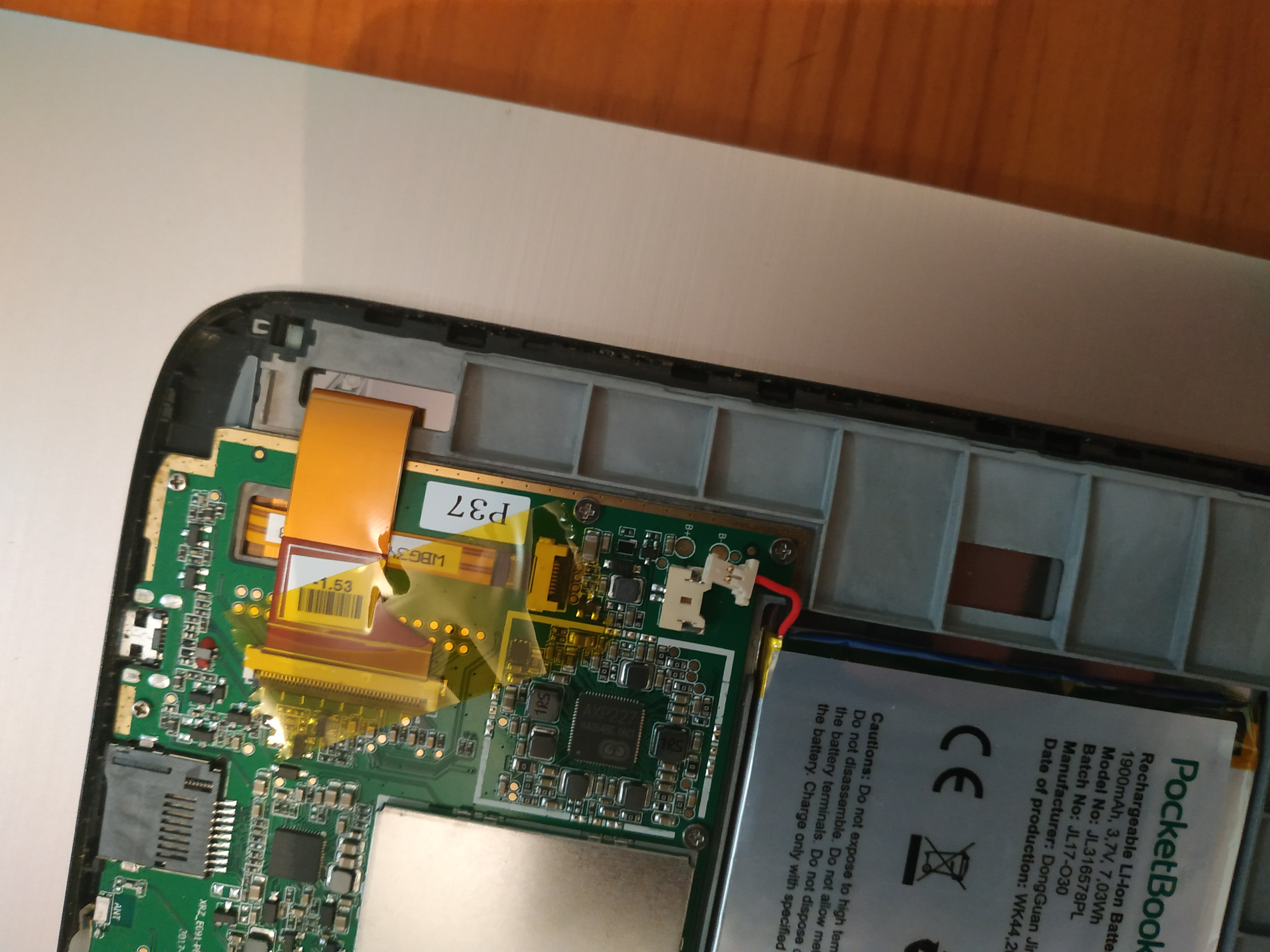

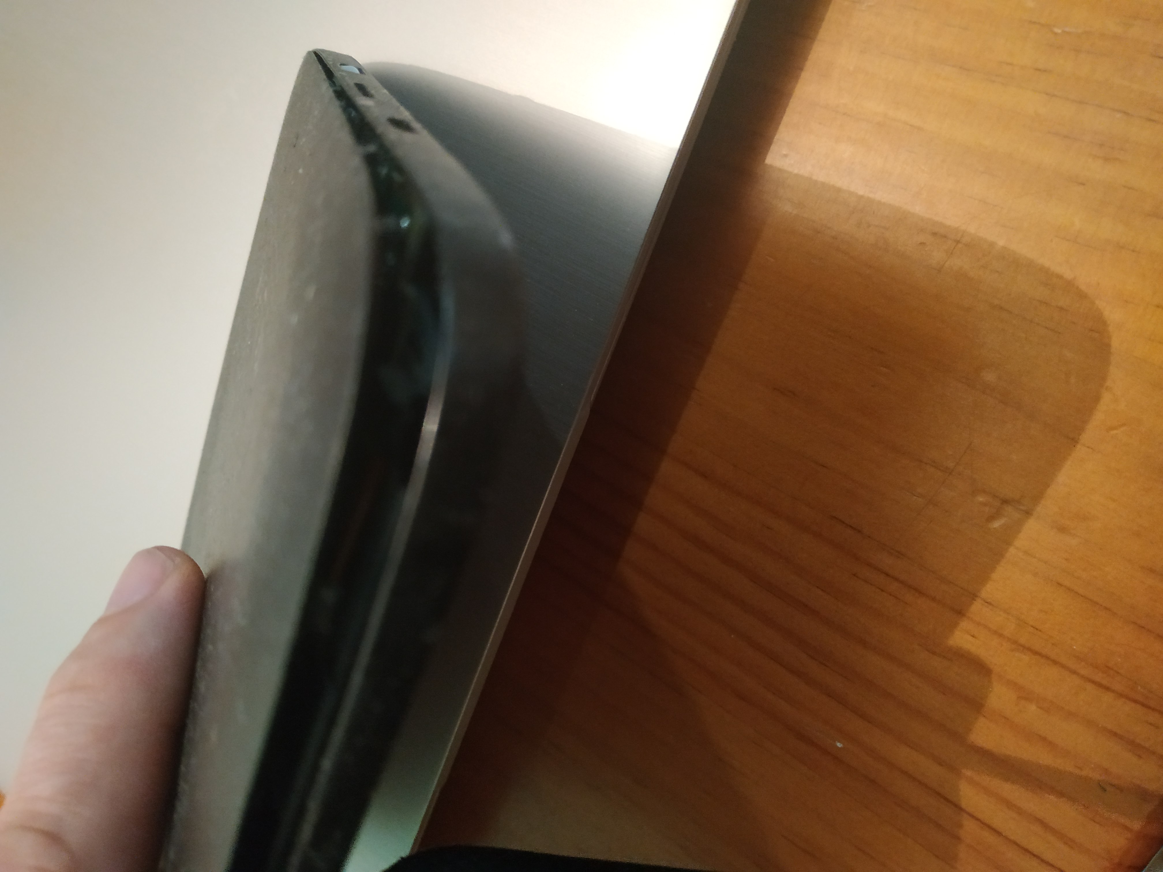

The InkPad 3 can be opened with your fingernail. No special tools are required. Then all you have to do is disconnect the battery tab.

ID:	196003   Click image for larger version

cellaris is offline   Reply With Quote
