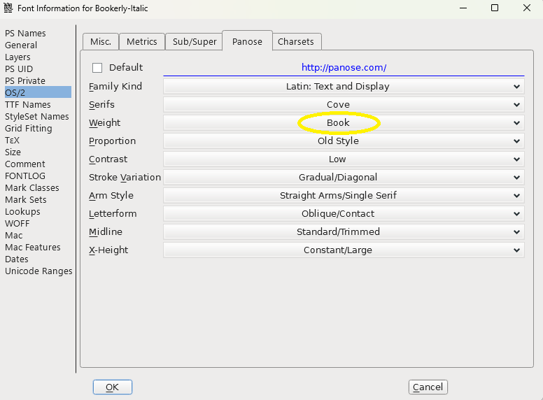

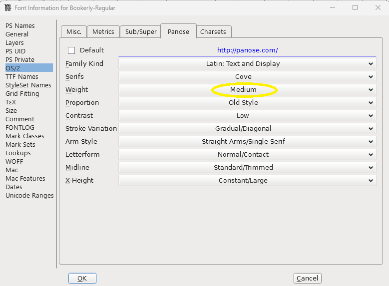

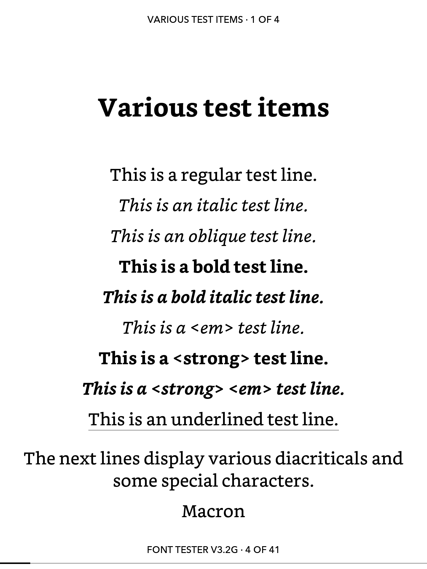

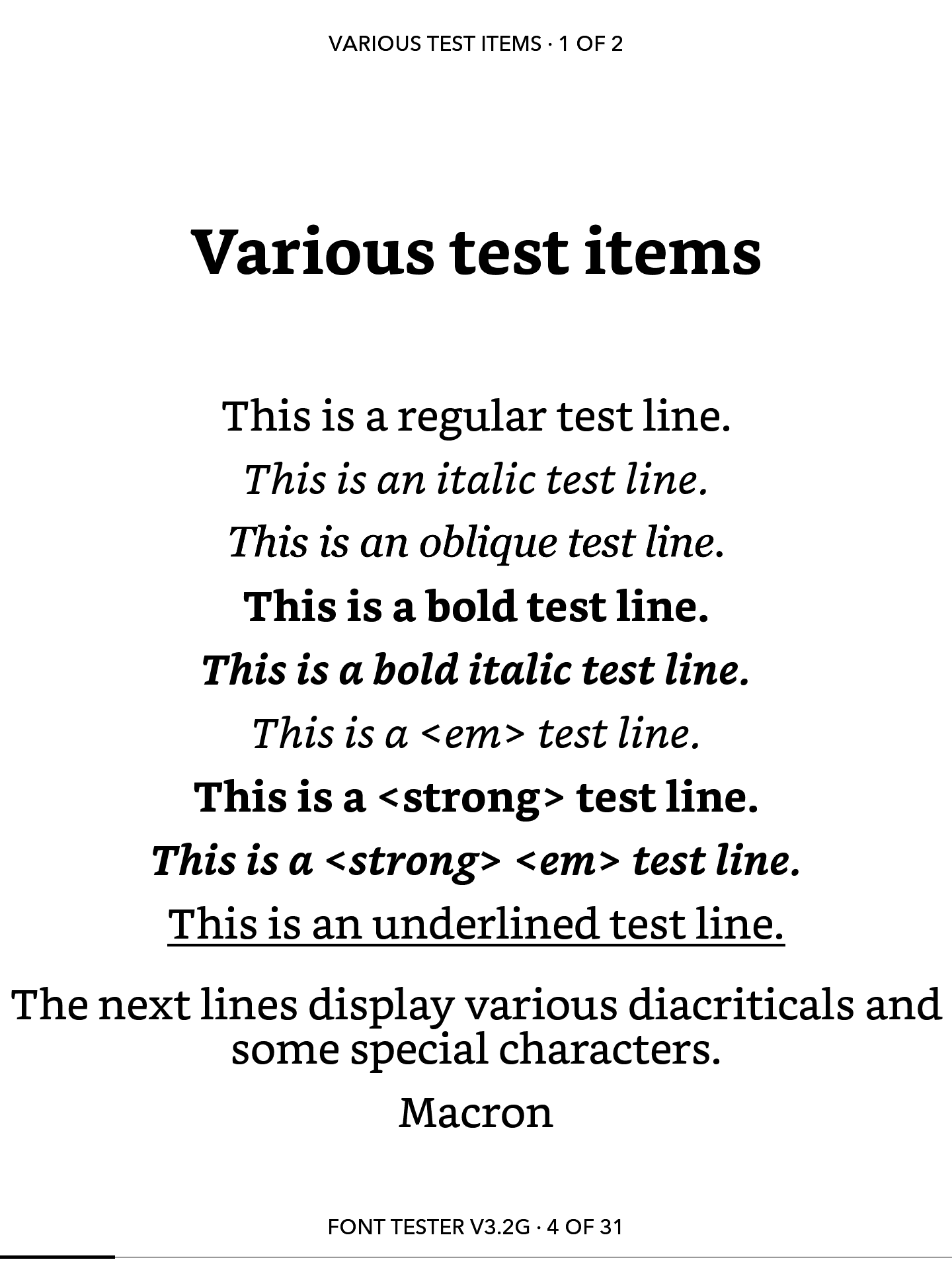

As for the Panose issue with the Bookerly font, I've attached two images of the old changes to the Panose weight from medium to book. As near as I can tell, with the current version of Bookerly extracted from recent Kindle firmware, the font file names are correct and the Panose weight does not seem to make any difference. I've attached images of my test ePub with Bookerly as the font without changes to the Panose weight (first image is a kepub, second image is an epub).
