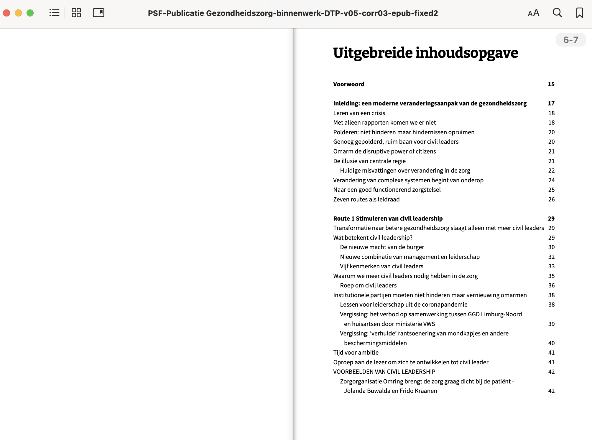

Hello Forum!
I've designed a ePub with a nested TOC. The problem I run into is that Apple Books is showing the levels incorrectly in the TOC. This is only happening with Apple Books. Other platforms seem OK as far as I can see.
The problem occurs when jumping 1 level back from a nested level. The program immediately jumps back to the beginning (main level) and not 1 level back. Thus showing the Paragraph heading in Bold. Thinking it's a chapter and not a Paragraph.
Some images to explain (sorry, it's in Dutch language):
TOC as shown in the print version:
pagina in boek.png (294.2 KB)
TOC as shown in ePub Apple Books:
png.gif inhoudsopgave via menu.png (218.9 KB)
Here is an image of the toc.xhtml code:
png.gif Screenshot 2023-05-12 at 10.45.22.png (342.6 KB)
Hope somebody knows what I'm doing wrong.

Open the epub in Sigil or Calibre's editor. Then navigate to the actual nav xhtml file. Does it exhibit the same issue? If not, then perhaps Books is finding an older incorrect toc.ncx (NCX) and displaying that instead of the NAV. In addition, the book may have an html toc xhtml file that was meant to be read by the user just like book content that is separate from the NAV and/or NCX that might be the issue. If so try loading that file in Sigil or Calibre's editor to verify it is correct.
If all possible sources for the info shown in the reader's TOC window are correct, then you know the bug is in the reader's code that parses the NAV or NCX.

Did a quick web search and found this bug report from 2016.
https://discussions.apple.com/thread/7419388
It had no answer. It appears to be exactly the same bug you are asking about. So my guess is this is a very long standing bug in how Books builds its toc from the NAV that Apple has no interest in fixing.
You might try simplifying it to be a 2-level level or just a 1-level NAV, then create a non-NAV xhtml table of contents to show the user that is more complete.

The bug limiting the indentation of the TOC to two levels in Apple Books remains unfixed. Interestingly, Apple Books can correctly display TOCs deeper than two levels. If you create a test document in Pages with a three-level table of contents and export it to EPUB, you'll initially only see two levels due to wrong indentation of the 3rd level. But if you edit the TOC in Sigil or Calibre to indent the third level, Apple Books will display it correctly.
