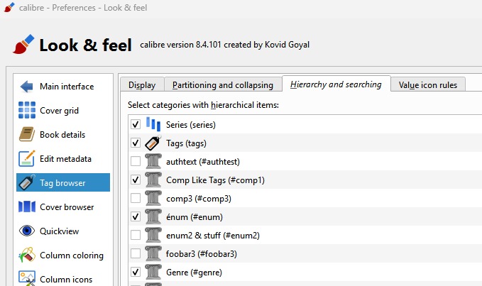

Please attach screen captures of the column definition (Preferences / Add your own columns), marking the column hierarchical (Preferences / Look & feel / Tag browser / Hierarchy and searching), and the tag browser entries for the column.

Also be sure that the period being used to separate the items in the hierarchy is a standard period, not some look-similar symbol.
I'm just using the normal period on the keyboard.
(Genre is my test field for the hierarchy issue, but other tag fields also don't work.)

Found the solution! I had Sort By on Number of books instead of Name and that stopped it from working.
That would have been my next question. Glad you got it sorted!
