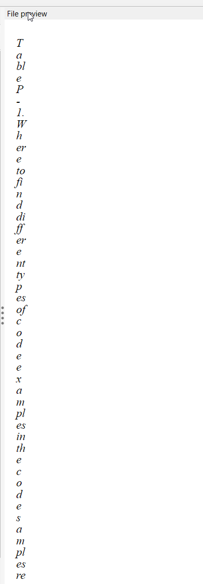

I have several ePubs which are rendering "table captions" incorrectly by displaying the text vertically. The problem exists both on the ereader (Kobo) and in Calibre ePub viewer, so I guess it must be a code issue.
Please refer to the screenshots to visualize the problem.
Any suggestion where I could start my investigation to fix that issue?

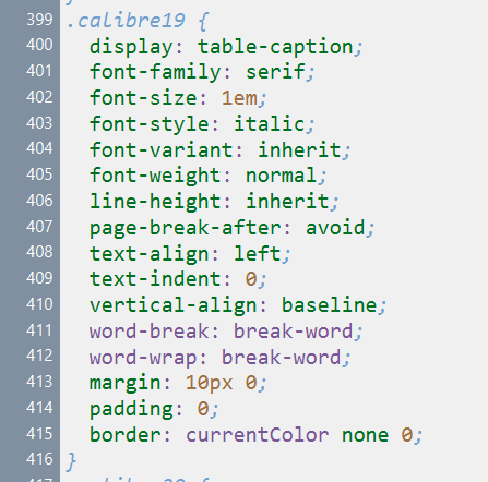

Some more info about the styles... (after Calibre conversion)

I found that in the "less_space" class, there is a parameter "white-space: pre-wrap;". If I comment out that line, the formatting is correct.
Now trying to find out what that line means... but I actually have a solution :-)
