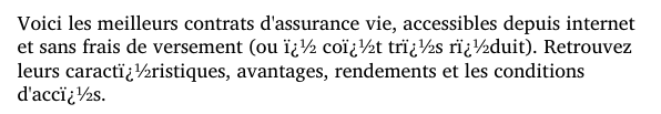

Hello,
I'm using a browser extension to convert HTML pages into EPUB files.
It works fine when the web page is in utf-8 but it doesn't like web pages encoded in iso-8859-1, where accented characters are replaced with question marks — the attached screenshots are when opening the EPUB file in SumatraPDF and Sigil.
To make matters worse, the extension replaces the encoding meta line with "charset="iso-8859-1".
I'd like to understand why accented characters are replaced with question marks. Is it a font issue? Or a problem with byte values?
Thank you.
Edit: I should have typed "the extension replaces the encoding meta line with "charset="utf-8"

If the html extension writes the epub file and adds the meta charset="iso-8859-1" that means the text is encoded that way. It must be read in as iso-8859-1 and recoded to utf-8 properly. Sigil can actually detect that and properly encode it as utf-8 but not if you change that charset meta info or improperly add the xml header saying it is utf-8 when it is not.
A better technique is to use a python script to read each html file in as iso-8859-1 (sometimes called latin-1) and recode it and write it out as utf-8.

Because it tries to interpret your document as UTF-8, finds invalid multibyte sequences, and translates it into the replacement character, which you see as � when you interpret the document as Latin-1.
You should consider other tools to convert HTML into EPUB.

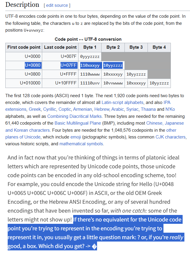

Thank you. I don't care about the tool. I wanted to understand why the problem occurs.
So what seems to happen under the hood when that extension reads bytes as utf-8 (because it doesn't support other code pages):
1. Any byte 128-255 is turned into two bytes, with a leading 00, so that, for instance, "é" is turned from 233 (0xE9) to "00233" (0x00E9)
2. The reason for the question marks is that the application looks for that two-byte codepoint in the font instead of the original single-byte codepoint

Yes, data must be read in binary and with the right decoder.
The extension only supports utf-8 and doesn't throw an error if a web page uses another encoding,eg. Latin1/iso-8859-1. It's the first time I had the issue in the weeks I've been using it, so it's no biggie. It was the opportunity to understand how both encodings work.
For the curious in the audience, here's how utf-8 works:
1. If a byte is worth 0-127, it remains untouched
2. If it's 128-159, it's considered wrong and replaced with the sequence "0xEFBFBD", ie. "�"
3. If it's 160-255, it's the leading byte of a two-byte combo
For instance, "É" in ISO-8859-1 is 0xC9 or 11001001 in binary. To convert it to utf-8, the first two bits (11) are put in the leading byte (11000011) and the other bits are put in the trailing byte (10001001) → 0xC389.
https://en.wikipedia.org/wiki/UTF-8#Description
