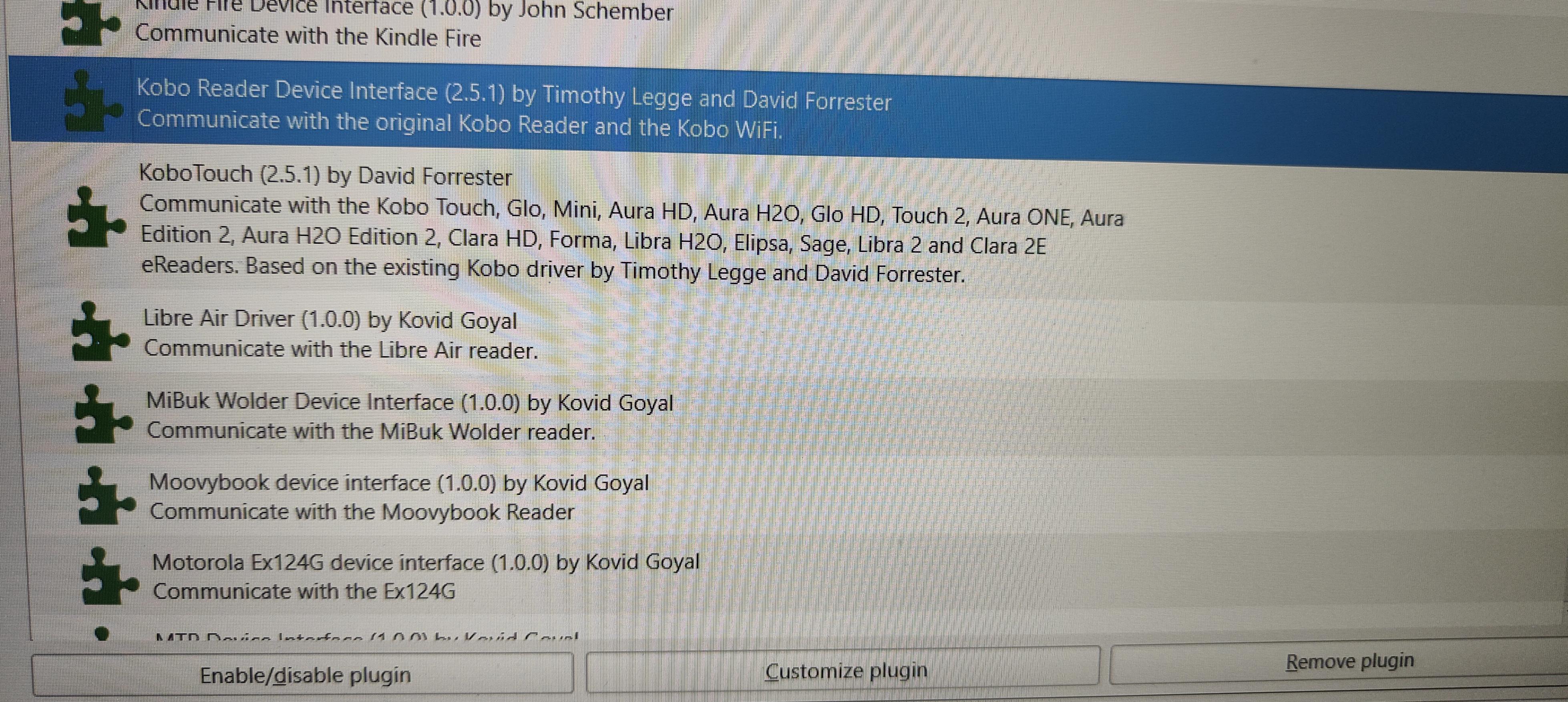

This is what I clicked on in Preferences see attached.
Sorry, it's the one BELOW the highlighted one that I clicked on.
