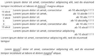

I read my epubs on a Kobo Aura H2O and write them as a hobby. I use Sigil and Caliber to edit them.
Here is the result I get on both Sigil and Caliber: when I stretch the text, it is correctly redisplayed:
On my Kobo, the lines overlap...

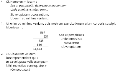

If I sideload the file in kepub, the behavior is correct... but then I have problems with the notes (styles not rendered in popups).
Should render like this:
In landscape mode? Because in portrait is impossible that lines are not overlapped.
Your epub has many errors; maybe if you first fix them, things work fine in your Kobo Aura.
Try fixing the errors because them are in notes.xhtml.
