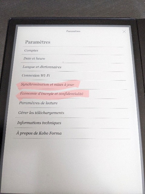

Thirdly, I decided to well do things: I unenabled both the automatic sleeping and waking up option and automatic sync (two different menus). I also put in “never” the two other automatic options: sleeping and shut down.
[LOOK TO IMAGE1]
All of this isn’t really satisfying since we all bought a device which should works independently of these choices. But until there, I’m not able to say if this step is important or not, so the following information work with this one.

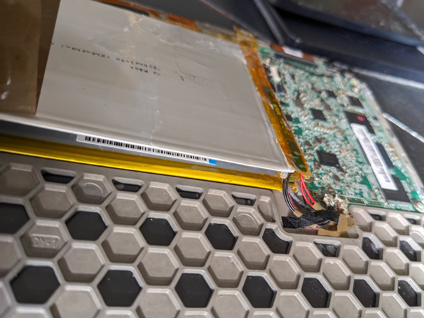

Bonus (if you purchased another battery):
I decided to benefit form my useless last purchase, so I also welded the second battery.
! Be careful of the area below the two points of meld, it’s just the screen below and you can easily damage it! I add some adhesive tape to protect it.
[LOOK TO IMAGE2]
(you can do better work, it’s just I don’t have my favorite pistol here)
I think my device isn’t more waterproof (and truly heavier), so be careful next summer on the beach 😉
You can close the device almost normally.
You can also choose to obtain another battery with a better capacity, but I could read that it doesn’t always fit neither.
