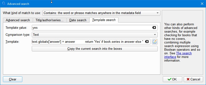

Use a "Template Search", which allows you to do more-or-less arbitrary things while searching. Your situation is exactly why I added it -- avoiding creating composite columns for one-off searches.
You get to Template Search using the advanced search button. Using the above python template as an example, the template search would be:
Thank you ,and good, because the python template is exactly what I understand
