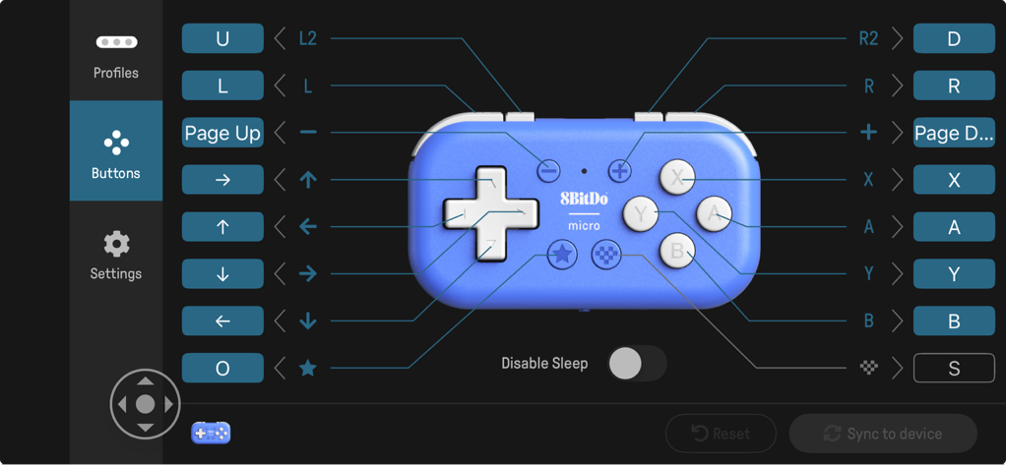

Step 1 – Set up your Bluetooth controller
• Skip this step if you are not using a controller that allows for custom mapping. Since I use the 8BitDo micro, I’ve included mapping for that device.
• I’ve set up mapping assuming controller usage in vertical orientation, but you may set it up any which way you like.
• 8BitDo micro will be used in keyboard mode. Go ahead and map random keyboard keys to all the buttons using the 8BitDo Ultimate Software. It does not matter which keyboard keys you map here. We will be noting down codes for all those keys later. For reference, this is how I’ve mapped my controller --> (See attached Picture 1)
• Note that I’ve mapped the ‘Keyboard right key’ to the Up D-Pad, and ‘Keyboard left key’ to the Down D-pad. This is on purpose since keyboard left and right arrow keys turn pages on the native Kobo reader without any additional setup. And since I hold the micro vertically, mapping it this way is more intuitive to me.

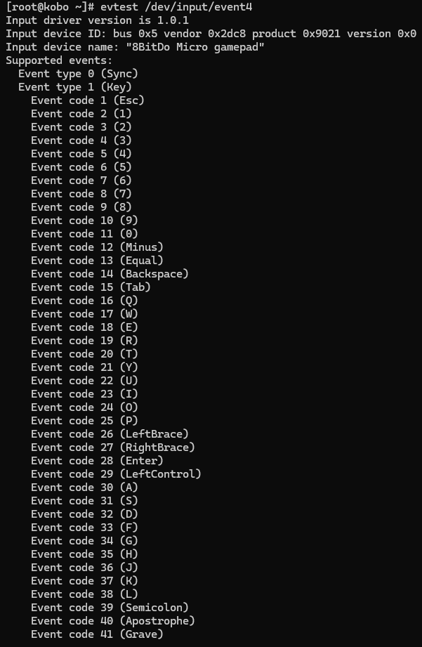

o Type
evtest /dev/input/event4
(replace ‘event4’ with whichever one you think is your connected controller)
o The terminal window will show a long list of Event codes, and then wait on ‘Testing … (interrupt to exit)’
-- At this point, if you press any key on the controller, you will get an event response. This confirms that your controller is indeed 'event4' (or whichever event# one you are testing).
-- Press Ctrl+C to exit back to the terminal prompt
o Scroll up in the terminal window to see the long list of Event codes. Now make note of whichever keys you mapped on your Bluetooth controller. For example, the line ‘Event code 20 (T)’ means that keyboard key ‘T’ has event code 20.
o In our case, the keys we mapped on the 8BitDo micro have event codes as follows –
Event code 103 (Up) — mapped to Left D-Pad
Event code 105 (Left) — mapped to Down D-Pad
Event code 106 (Right) — mapped to Up D-Pad
Event code 108 (Down) — mapped to Right D-Pad
Event code 104 (PageUp) — mapped to minus
Event code 109 (PageDown) — mapped to plus
Event code 21 (Y) — mapped to Y
Event code 45 (X) — mapped to X
Event code 48 (B) — mapped to B
Event code 30 (A) — mapped to A
Event code 38 (L) — mapped to Left Trigger L
Event code 22 (U) — mapped to L2
Event code 32 (D) — mapped to R2
Event code 19 (R) — mapped to Right Trigger R
Event code 24 (O) — mapped to Star button

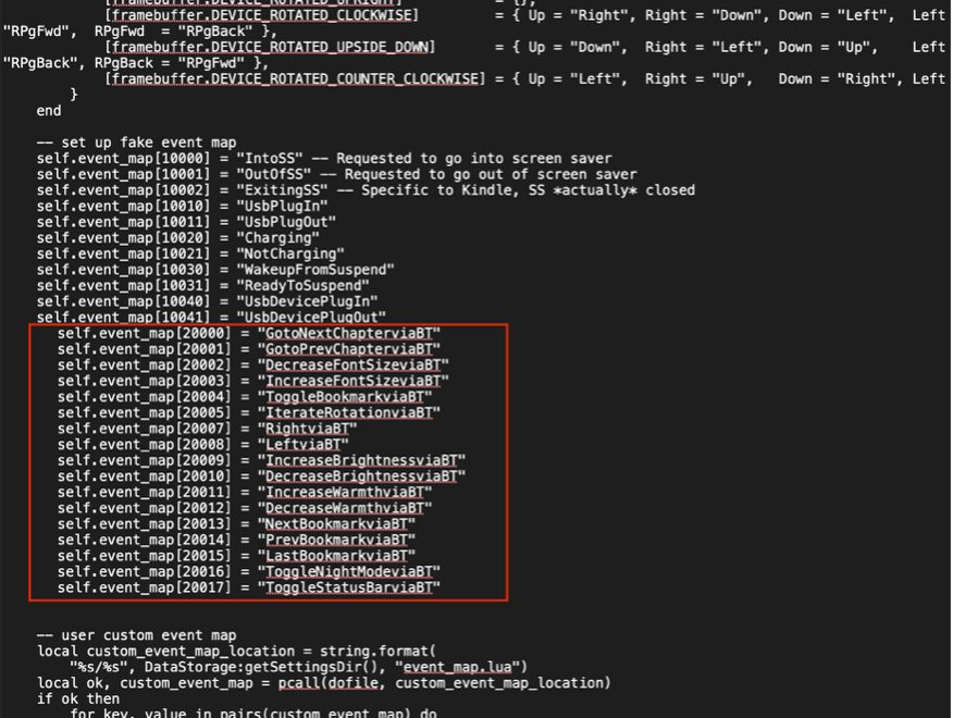

• Scroll down to the section which has the header – set up fake event map (This section has lines that look like Self.event_map[10000] = “IntoSS”)
• Add the following lines to this section –
self.event_map[20000] = "GotoNextChapterviaBT"
self.event_map[20001] = "GotoPrevChapterviaBT"
self.event_map[20002] = "DecreaseFontSizeviaBT"
self.event_map[20003] = "IncreaseFontSizeviaBT"
self.event_map[20004] = "ToggleBookmarkviaBT"
self.event_map[20005] = "IterateRotationviaBT"
self.event_map[20007] = "RightviaBT"
self.event_map[20008] = "LeftviaBT"
self.event_map[20009] = "IncreaseBrightnessviaBT"
self.event_map[20010] = "DecreaseBrightnessviaBT"
self.event_map[20011] = "IncreaseWarmthviaBT"
self.event_map[20012] = "DecreaseWarmthviaBT"
self.event_map[20013] = "NextBookmarkviaBT"
self.event_map[20014] = "PrevBookmarkviaBT"
self.event_map[20015] = "LastBookmarkviaBT"
self.event_map[20016] = "ToggleNightModeviaBT"
self.event_map[20017] = "ToggleStatusBarviaBT"
• The numbers in the brackets above are just random numbers I picked. They don’t have any significance here.
• Screenshot for reference --> see attachment Picture 2

Step 3 – Confirm ‘event#’ for your controller and note event keys
• Make sure your controller is connected via Bluetooth. Open KOReader.
• Log into KOReader via SSH
o KOReader --> Gear icon --> Network --> SSH Server
o Tick ‘Login without password (DANGEROUS)’, and then tick ‘SSH server’. (Of course you can choose to set up SSH credentials, but we’ll directly log in for sake of convenience).
o Take note of the device’s internal IP address on the pop-up screen
o On your computer open Terminal if on Mac or Linux, Command Prompt if on Windows
o Enter
ssh -p 2222 root@(ip-address-you-noted above)
o You will be asked if you want to continue, and no password is required (just hit enter)
o Enter
ls /dev/input
o This will show inputs connected to your Kobo, something like –
By-path    event0    event1    event2   event3    event4
o Typically, the last one will be your Bluetooth device if you haven’t connected multiple Bluetooth devices to the Kobo. To check which one is your controller, you can try this step with and without your controller connected. When it’s not connected, that event# will not be there. In my case, ‘event4’ shows up when the 8BitDo controller is connected, and is missing when it’s not. This confirms the 8BitDo controller is ‘event4’.
o Type

Step 4 – Update input.lua file
• Connect your ereader to you computer via USB
• Navigate to KOBOeReader/.adds/koreader/frontend/device
• Take a backup of the input.lua file, so you can place the original back and start over if anything goes wrong.
• Open input.lua
• Scroll down further till you reach a function called Input:handleKeyBoardEv(ev). The following lines need to be within this function. I placed them just before a section with the header -- toggle fullscreen on F11.
if self:isEvKeyPress(ev) and keycode == "GotoNextChapterviaBT" then
UIManager:sendEvent(Event:new("GotoNextChapter"))
end
if self:isEvKeyPress(ev) and keycode == "GotoPrevChapterviaBT" then
UIManager:sendEvent(Event:new("GotoPrevChapter"))
end
if self:isEvKeyPress(ev) and keycode == "DecreaseFontSizeviaBT" then
UIManager:sendEvent(Event:new("DecreaseFontSize", 1))
end
if self:isEvKeyPress(ev) and keycode == "IncreaseFontSizeviaBT" then
UIManager:sendEvent(Event:new("IncreaseFontSize", 1))
end
if self:isEvKeyPress(ev) and keycode == "ToggleBookmarkviaBT" then
UIManager:sendEvent(Event:new("ToggleBookmark"))
end
if self:isEvKeyPress(ev) and keycode == "IterateRotationviaBT" then
UIManager:sendEvent(Event:new("IterateRotation"))
end
if self:isEvKeyPress(ev) and keycode == "RightviaBT" then
UIManager:sendEvent(Event:new("GotoViewRel", 1))
end
if self:isEvKeyPress(ev) and keycode == "LeftviaBT" then
UIManager:sendEvent(Event:new("GotoViewRel", -1))
end
if self:isEvKeyPress(ev) and keycode == "IncreaseBrightnessviaBT" then
UIManager:sendEvent(Event:new("IncreaseFlIntensity", 5))
end
if self:isEvKeyPress(ev) and keycode == "DecreaseBrightnessviaBT" then
UIManager:sendEvent(Event:new("DecreaseFlIntensity", 5))
end
if self:isEvKeyPress(ev) and keycode == "IncreaseWarmthviaBT" then
UIManager:sendEvent(Event:new("IncreaseFlWarmth", 1))
end
if self:isEvKeyPress(ev) and keycode == "DecreaseWarmthviaBT" then
UIManager:sendEvent(Event:new("IncreaseFlWarmth", -1))
end
if self:isEvKeyPress(ev) and keycode == "NextBookmarkviaBT" then
UIManager:sendEvent(Event:new("GotoNextBookmarkFromPage"))
end
if self:isEvKeyPress(ev) and keycode == "PrevBookmarkviaBT" then
UIManager:sendEvent(Event:new("GotoPreviousBookmarkFromPage"))
end
if self:isEvKeyPress(ev) and keycode == "LastBookmarkviaBT" then
UIManager:sendEvent(Event:new("GoToLatestBookmark"))
end
if self:isEvKeyPress(ev) and keycode == "ToggleNightModeviaBT" then
UIManager:sendEvent(Event:new("ToggleNightMode"))
end
if self:isEvKeyPress(ev) and keycode == "ToggleStatusBarviaBT" then
UIManager:sendEvent(Event:new("ToggleFooterMode"))
end
• Screenshot for reference --> see attachment Picture 3

Step 5 – Update device.lua file
• Navigate to KOBOeReader/.adds/koreader/frontend/device/kobo
• Take a backup of the device.lua file, so you can place the original back and start over if anything goes wrong.
• Navigate to the section that has event maps (Starts with event_map = {)
• Here you will add lines for the features that you want, and map them against the buttons you’ve picked. So, for example, assume we want to map 'increase font size' to the L2 button. On the 8BitDo app we mapped L2 button on the controller to keyboard key ‘U’. And we noted in our event map codes that keyboard key U had event code 22. And so here we will add the event “IncreaseFontSizeviaBT” against code [22]. See format below.
• I’m including below, lines I added for my setup. But you can change these to whichever keys and features you prefer. The “RightviaBT”/“LeftviaBT” are functionally same as “RPgFwd”/ “RPgBack” on Libra eReaders. RPgFwd/RPgBack events are triggered by the physical buttons on that eReader. You can use either set if you using the Libra Colour.
[105] = "LeftviaBT", -- You can also use "RPgBack" on Libra Colour
[106] = "RightviaBT", -- You can also use "RPgFwd" on Libra Colour
[103] = "GotoNextChapterviaBT", -- D-pad left (Up when held vertically)
[108] = "GotoPrevChapterviaBT", -- D-pad right (Down when held vertically)
[21] = "IncreaseBrightnessviaBT", -- Y-button
[30] = "DecreaseBrightnessviaBT", -- A-button
[45] = "IncreaseWarmthviaBT", -- X-button
[48] = "DecreaseWarmthviaBT", -- B-button
[22] = "IncreaseFontSizeviaBT", -- L2 button
[32] = "DecreaseFontSizeviaBT", -- R2 button
[104] = "IterateRotationviaBT", -- Minus button
[109] = "ToggleNightModeviaBT", -- Plus button
[38] = "RightviaBT", -- Left Trigger L
[19] = "LeftviaBT", -- Right Trigger R
• Screenshot for reference --> see attachment Picture 4
• Scroll down a bit further and place the following lines after self.input: open(“fake_events”). The exact placement shouldn’t matter as long as it’s as long as it’s within the function Kobo:init(), and placed between logic blocks in that function –
local success1, event4res = pcall(function()
self.input:open("/dev/input/event4")
end)
• Needless to say, if your event# was different you will put that event# here instead.
• Screenshot for reference --> see attachment Picture 5
• Save and close the file
Step 6 – Wrap up
• You are now done. Eject the Kobo ereader from your computer.
• Reboot just to be safe.
• Since this method does not rely on any plug-ins, you will need to connect the controller before opening KOReader. And again, till the KOReader bug mentioned earlier is fixed, remember to reboot the device to exit KOReader.
• The final key mapping used in these instructions is shown in the Picture 6 attachment.
Additional Notes:
• If you don’t care about advanced features, and only care about basic page turn buttons, you can skip the entirety of Step 4. On Step 5, you only need to enter the two lines for mapping “RPgFwd” and “RPgBack” and the “local success1…” lines.
• The Next Chapter/Previous Chapter functionality doesn’t work perfectly if you change the font-size after opening the book. I imagine this is a bug in KOReader, where chapter locations are not updated dynamically after changing the font size. If you close the book and open it again after changing font size, the chapter skips work perfectly again.
Hope this helps! Best of luck!
