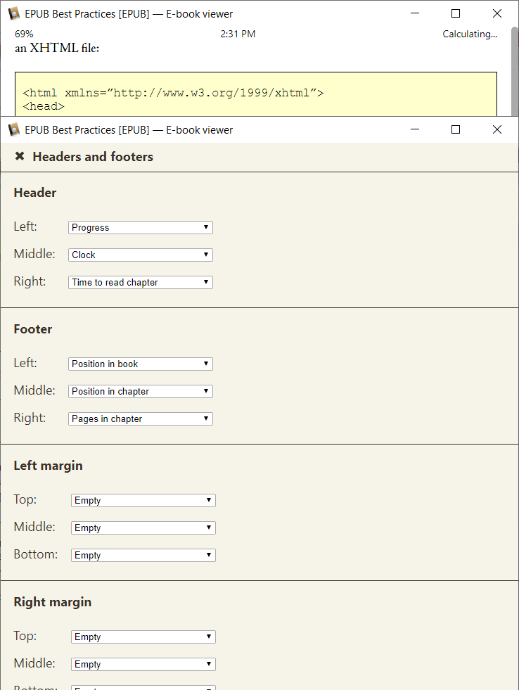

You have looked at the settings for the ebook viewer? Right click, select preferences and look at the Header/Footer settings. And note that these are percentages or screen numbers not "page numbers".

That information is still available. However many users preferred to see a simple pane with the book so you have to enable the page number options, clock, etc.

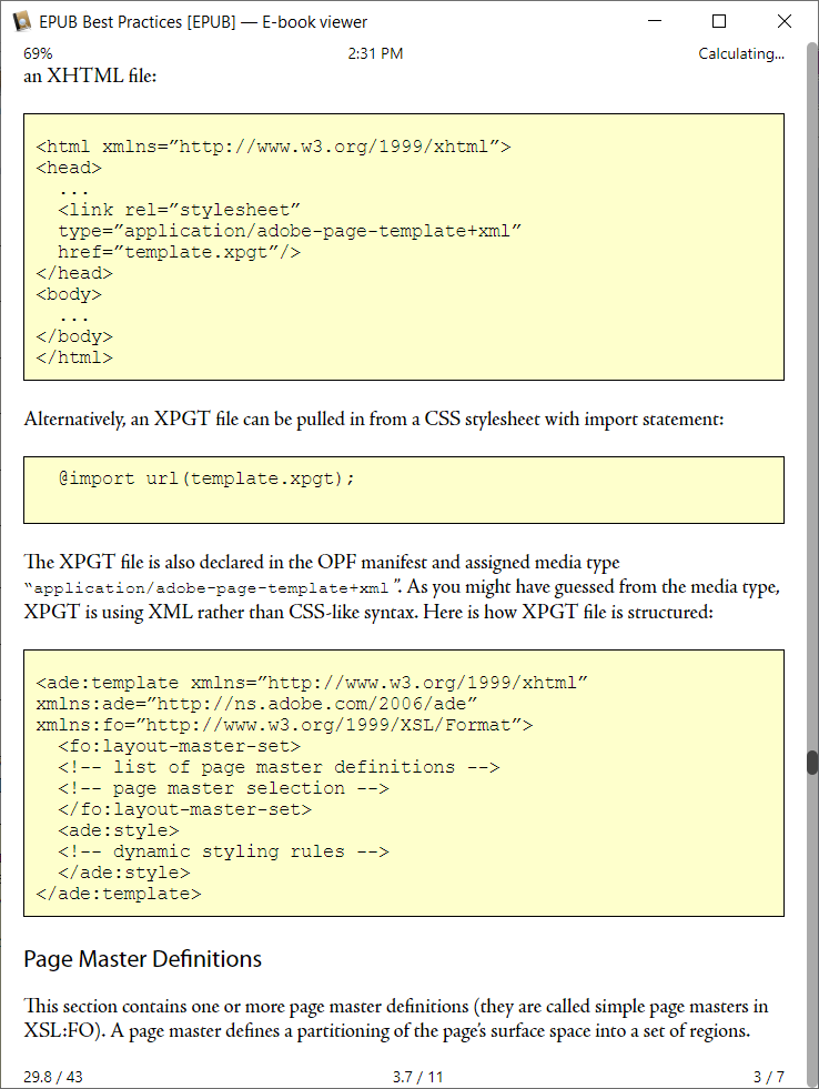

See attached images for ebook-viewer and ebook-viewer preferences. Note that the time to read needs a certain amount of page flips before usable information can be calculated.
