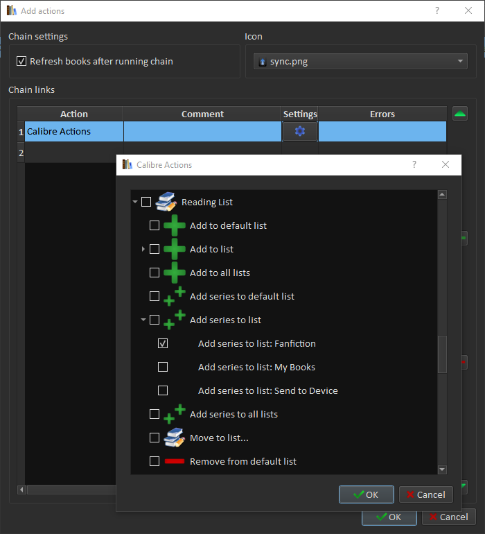

Here's where to look when adding an action:
Name:	2020-12-13 16_56_10-Add actions.png
I have a chain to add to my send-to-device list, update the #onkobo column, and edit the #kobocoll column.
