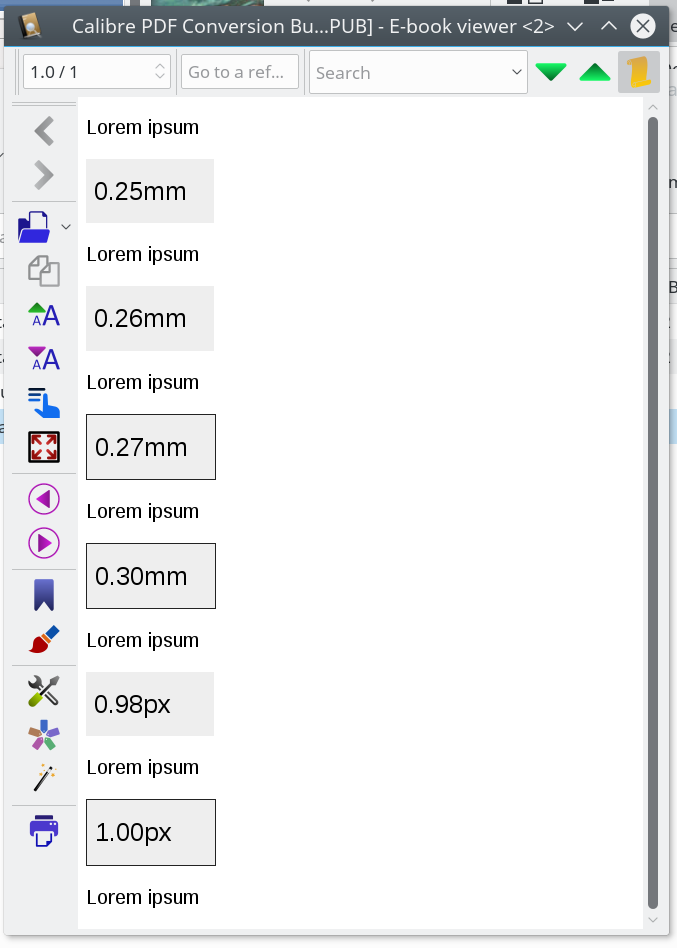

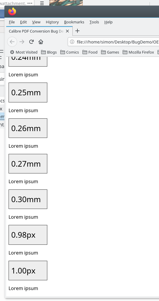

Sample files and screenshots attached .... I think. Calibre and Firefox screenshots, epub and pdf samples.
Anyone wanting to use the skeleton epub for their own purposes is welcome to.
However I can't reproduce the thin lines showing correctly in calibre right now. I fiddled with display and export settings a lot, and I'm no longer certain I definitely looked at the ultra-thin lines in the Calibre viewer - thinking back, I may have been loading into Calibre and jumping straight to pdf export by that stage.
However, even lines that thin could print out at 360dpi on A4, which is the intended target. There's no special reason you can't have a 0.5px line, on an ultra- hi-res display, is there?

The viewer and PDF export both happen via Chromium (Qt WebEngine to be exact). There isn't any cotrol I have over the process. If Chromium doesnt like rendering 0.5px lines, it doesnt, end of story.

@pdurrant - the first page is the autogenerated cover, which is a bitmap. Second page, which looks the same, is the proper text.
@DNSB I did mean 0.5px. Yes, a line that thin might well be too thin to display on-screen at ~96dpi. But it wouldn't be too thin to display on paper at ~360dpi. Unfortunately it never manages to get that far.
@kovidgoyal That's fair then. Thank you for clarifying, and so quickly too.

In my case, I didn't mind what the exact values were - I can use 0.5mm, 0.75mm, 1.0mm just fine, now I know 0.25mm is too thin. It's just a little bit annoying when 0.25mm is a nice round number and it's almost 1px wide anyway darnit. (BTW, it looks like Firefox simply rounds 0.5px up to 1. 0.49px lines vanish on Firefox too.)
