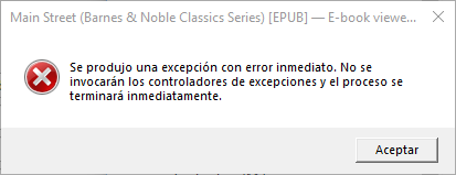

Windows 10 in Spanish. I get an exception immediately after viewing any ebook. The viewer works fine otherwise, this just happens when the viewer is closed.
The text reads something like this "Immediate error. Exception controllers will not be called. Process will end".
Any ideas?

https://www.mobileread.com/forums/sh...d.php?t=327263

Yes, that's it. Enabling wersvc fixed the problem. Thank You!
