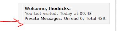

You should have seen a notice in the forum about a PM.
Greenies have a bit more access to your sign up details, than the res of us, so they may be able to use you email instead of PrivateMessage
