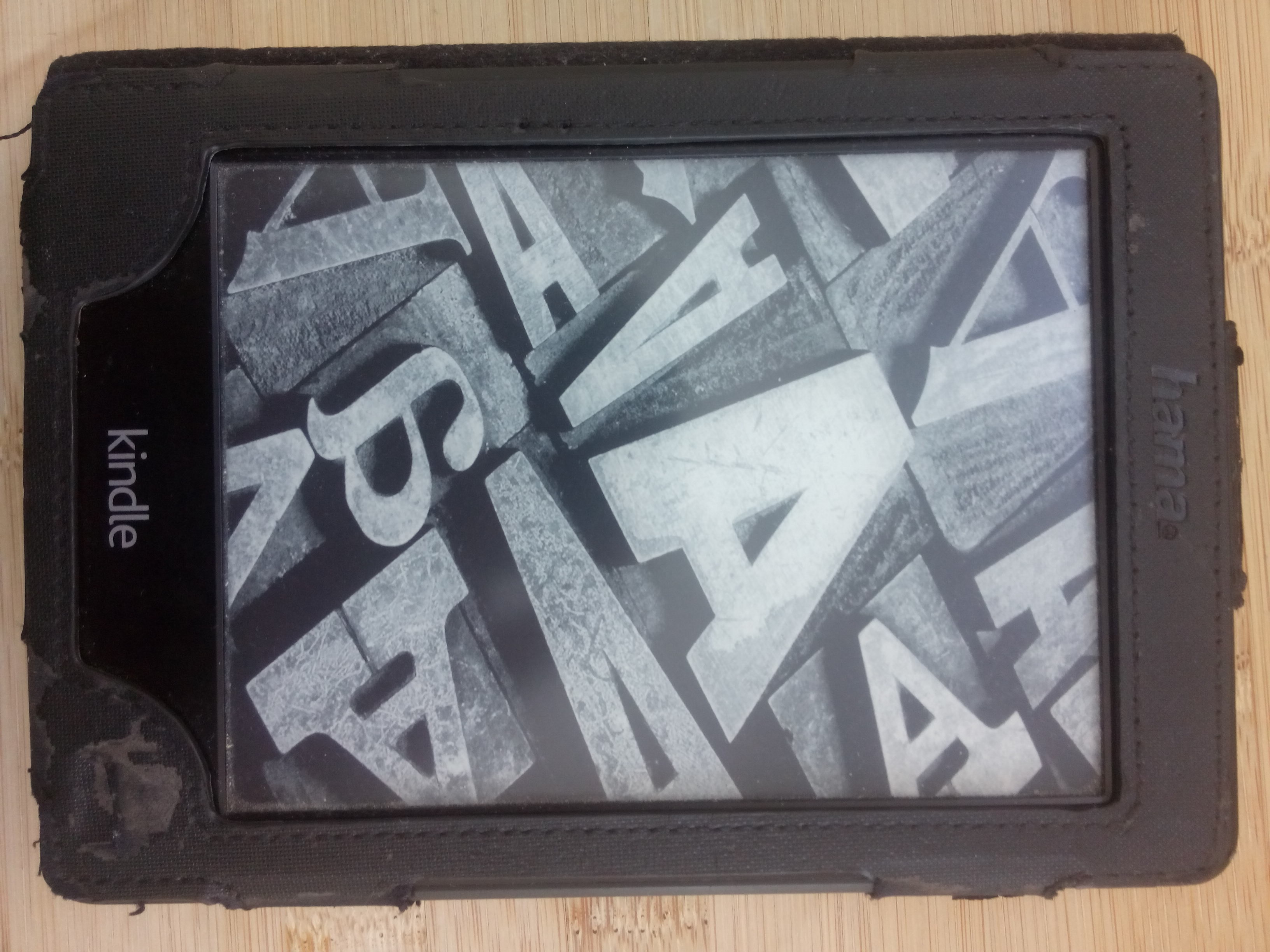

Old 04-20-2020, 11:50 AM   #11
jimmiejacks0rn
jimmiejacks0rn began at the beginning.
Posts: 17
Join Date: Feb 2020
Device: PW2
Hmm... I never seen ads in seven years.

Old 04-20-2020, 01:55 PM   #12
NiLuJe
BLAM!
NiLuJe's Avatar
Posts: 13,506
Karma: 26047202
Location: Paris, France
Yeah, no, that's a standard non-SO screensaver.
Unless the fact that it's unregistered messes w/ things, I'm out of ideas.
