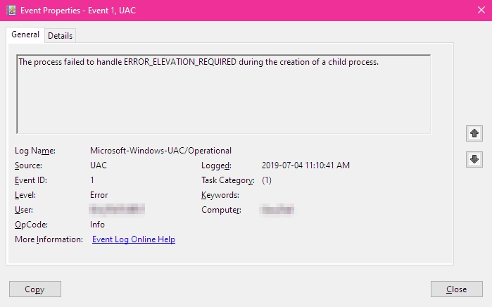

I am the Administrator of the PC, I have UAC set to "do nothing", and I execute Calibre "As Administrator".
As previously mentioned, the problem exists even if --ignore-plugins is specified.
ADDED/CHANGED: resetting the auto-add folder permissions properties to "Full-Control" for me, Administrators, Everyone, etc. did NOT remove "Error 740", but it DID show that the ORIGINAL code was considering the epubs as being readable and writable. So,it appears that it is necessary but not sufficient that the permissions of the auto-add folder be minimal/loose.
ADDED:
This is what Microsoft says about the above UAC error shown in the attached image:
 This this is the purpose of UAC, it strips admin privileges from normally-launched processes.
This encourages you to not use dangerous admin powers where you don't need to. You may try to modify the UAC on Local Security Policy for test:
 1 Login with Administrator
  2 Type in secpol.msc into the Start menu search box and hit enter
 3 browse  down to Local Policies \ Security Options\ User Account Control:  Behavior of the elevation prompt for administrators in Admin Approval  Mode” and double-click on it.
 4 Change the setting to “Elevate without prompting”.

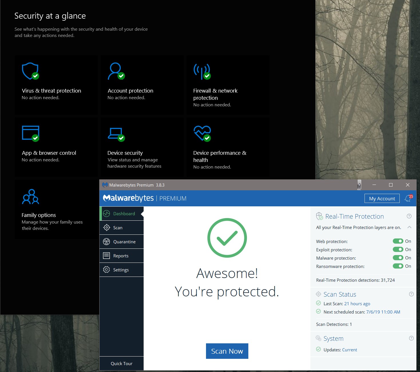

Is Ransomware protection activated?
[*] For Defender, I do not use the "Controlled Folder Access", so, no. Also, Defender real-time protection is turned off automatically by Windows 10 because I use another anti-virus application, Malwarebytes. Defender just runs "periodic scans" by itself.
[*] For Malwarebytes, yes. However, turning off Malwarebytes ransomware protection changes nothing.

[*] Running as User fails even os.R_OK.
[*] Running as Administrator passes os.R_OK but fails os.W_OK.
Never has been for me. Running as Admin never has caused any problems whatsoever for me since 2013. Also, Windows 10 1903 security permissions are a far cry from Windows 10 0001 and Windows 7 security permissions. Microsoft is strengthening them every month, and changing how it updates existing Windows 10 installations every month. Comparing an "old" Windows 10 installation to a "newly upgraded" Windows 10 1903 installation to a "fresh from the factory 1903 OEM installation" is comparing apples and oranges. Every installation is unique.
Sounds like a can of worms, it would be interesting to know if any other Windows 1903 users are experiencing similar problems.
Interesting: is that 'turning off automatically' a feature introduced in 1903, or is it a feature of Home. I run Defender and MWB and all options in both are on - and I only exclude one folder from either - my sweather tray app, which MWB thinks is a trojan.
Name:	Annotation 2019-07-06 085216.jpg
