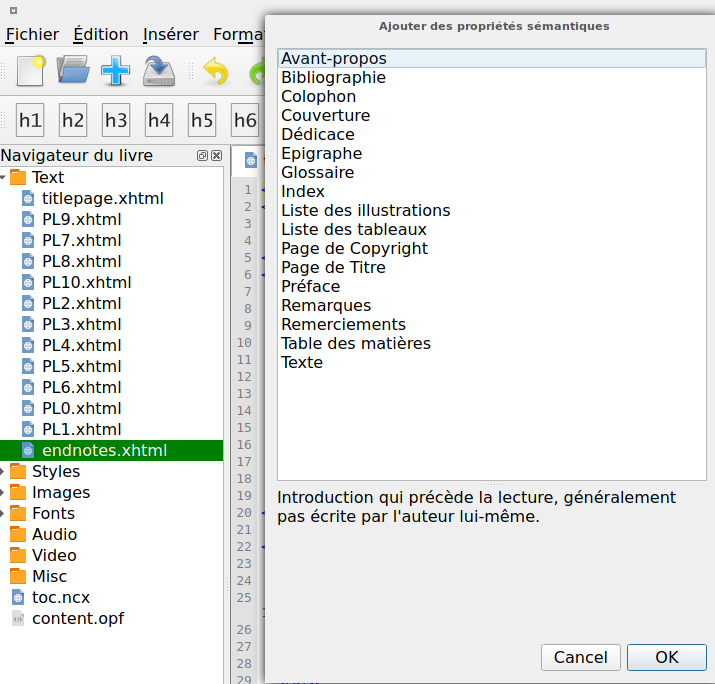

Adding semantics to ePub 2.0: where are "Notes"?
Hi
Using Archlinux. Sigil 0.9.10
I tried to add the semantics value "Notes" to an ePub2 and failed to find it (see screenshot). I had to do it with the Calibre editor.

Old 01-08-2019, 06:00 AM   #2
Posts: 21,996
Karma: 30277294
Has Notes been translated as Remarques ?
Old 01-08-2019, 07:18 AM   #3
DiapDealer
DiapDealer's Avatar
Posts: 28,842
Karma: 207000000
"Remarques" does indeed insert a guide item of type "notes".
Old 01-08-2019, 07:25 AM   #4
roger64
Posts: 2,625
Karma: 3120635
Device: Kindle PW3 (wifi)
OK Thanks.
"Remarques" may be a bit overzealous, "Notes" is quite good even in French and probably more helpful.

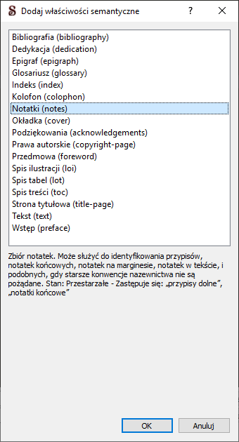

Old 01-08-2019, 12:15 PM   #10
BeckyEbook
BeckyEbook's Avatar
Posts: 898
Karma: 3501166
Join Date: Jan 2017
Location: Poland
Idea: Use English abbreviated names in brackets after translation.

Old 01-08-2019, 05:57 PM   #11
Posts: 21,996
Karma: 30277294
OK Thanks.
Blame Sergey Brin's Alphabet Soup
Good one, too. But that's up to the translators.
Old 01-08-2019, 09:03 PM   #12
DiapDealer
DiapDealer's Avatar
Posts: 28,842
Karma: 207000000
Actually, we could pull it off without involving them. We could just build the string and leave the parenthetical English portion out of the tr function. The translators would never see it.
The doubled entries would look a little weird whenever English was the selected UI language, however:
Text (text)
Notes (notes)
Table of Contents (toc)
Glossary (glossary)

Old 01-15-2019, 07:25 AM   #14
un_pogaz
Chalut o/
un_pogaz ought to be getting tired of karma fortunes by now.un_pogaz ought to be getting tired of karma fortunes by now.un_pogaz ought to be getting tired of karma fortunes by now.un_pogaz ought to be getting tired of karma fortunes by now.un_pogaz ought to be getting tired of karma fortunes by now.un_pogaz ought to be getting tired of karma fortunes by now.un_pogaz ought to be getting tired of karma fortunes by now.un_pogaz ought to be getting tired of karma fortunes by now.un_pogaz ought to be getting tired of karma fortunes by now.un_pogaz ought to be getting tired of karma fortunes by now.un_pogaz ought to be getting tired of karma fortunes by now.
un_pogaz's Avatar
Posts: 483
Karma: 678910
Join Date: Dec 2017
Device: Kobo
That's a great idea. A translation is very practical but the English terms are the ones used internally in the ePub, it can be useful to have them some here.
Since you will (probably) modify the code, you could add an exclusion condition for the English.
