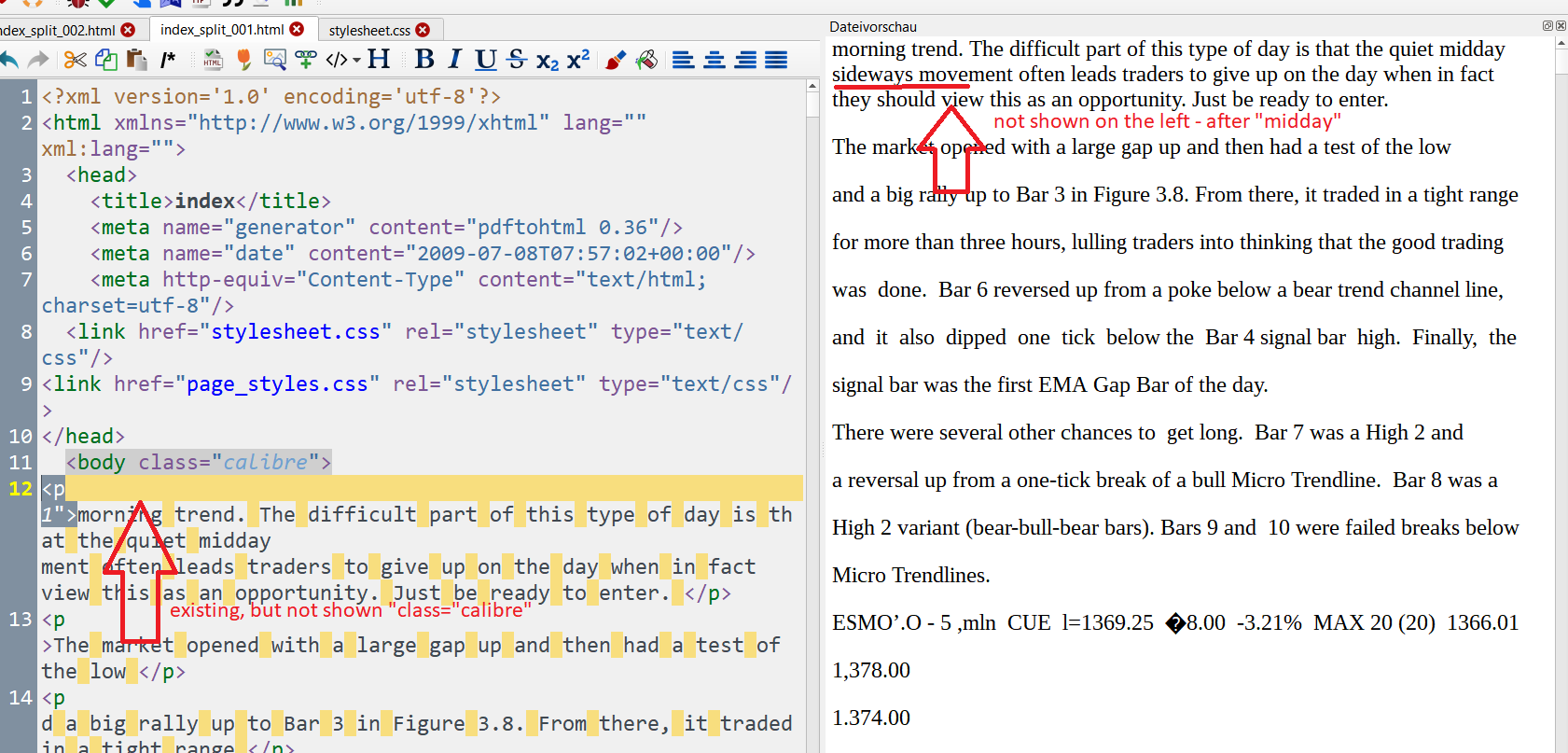

Hi everybody,
I'm on Win 10, Eval. 18234.
I converted a pdf using Calibre. In the editor it's looking like this:
Why can't I see this stuff?

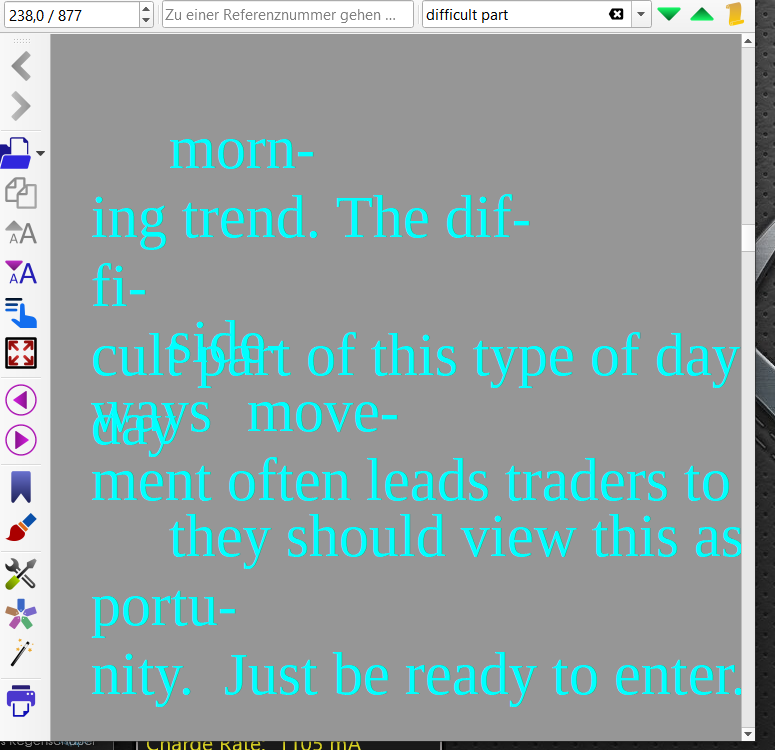

The Calibre Viewer shows it like:

Why is the viewer showing text on top of each other?
Thanks everyone.

If the code screen capture is full left margin
The HTML tags are severely mangled.
<p class="indent">Below him,
NOT
[edited]
<p
class="indent"> Below him,
I don't believe a tag can have a newline

Old 10-29-2018, 04:36 PM   #5
Posts: 31,343
Karma: 62025226
Interesting that it used a non-breaking space rather than a standard space.
that would account for the visual mess in the tags between the tag and attribute. all the rest is being treated as an unbroken line

Old 11-07-2018, 01:23 PM   #8
jackie_w
Posts: 6,280
Karma: 16800000
It's the adjacent non-breaking spaces which cause this problem of some text being invisible in the Editor - usually around the line wrap area. I see it quite often.
I have a vague memory, from a while ago, that it's a known problem with the underlying Qt library, i.e. not fixable by calibre alone.
Old 11-07-2018, 04:34 PM   #9
Posts: 22,060
Karma: 30277960
↑ ↑ ↑ - likewise.
It's one of the reasons why I use Sigil for editing the code.
