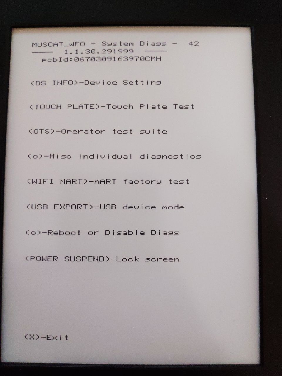

Hello, everybody,
Today, after a long time without reading or using my Kindle, I took the device and was without battery, 0% battery, I connected my Kindle by USB to a charger, the device was started as a display on the screen.
Can anyone tell me why this happened?
The PW3 G090G1 device had the FW 5.9.4 and jailbreak.
Can someone help me?
I'm sorry for my bad communication.
Thanks

Originally Posted by tyi2ael View Post
Hello, everybody,
Thanks
If you had jailbroken, and installed Cowards Rescue Pack, this happened because you booted it up with a USB plug plugged into it.
Let it charge for a while.
Unplug the usb cord.
Reboot

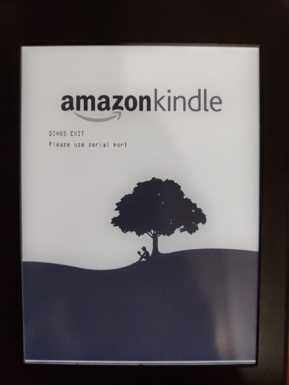

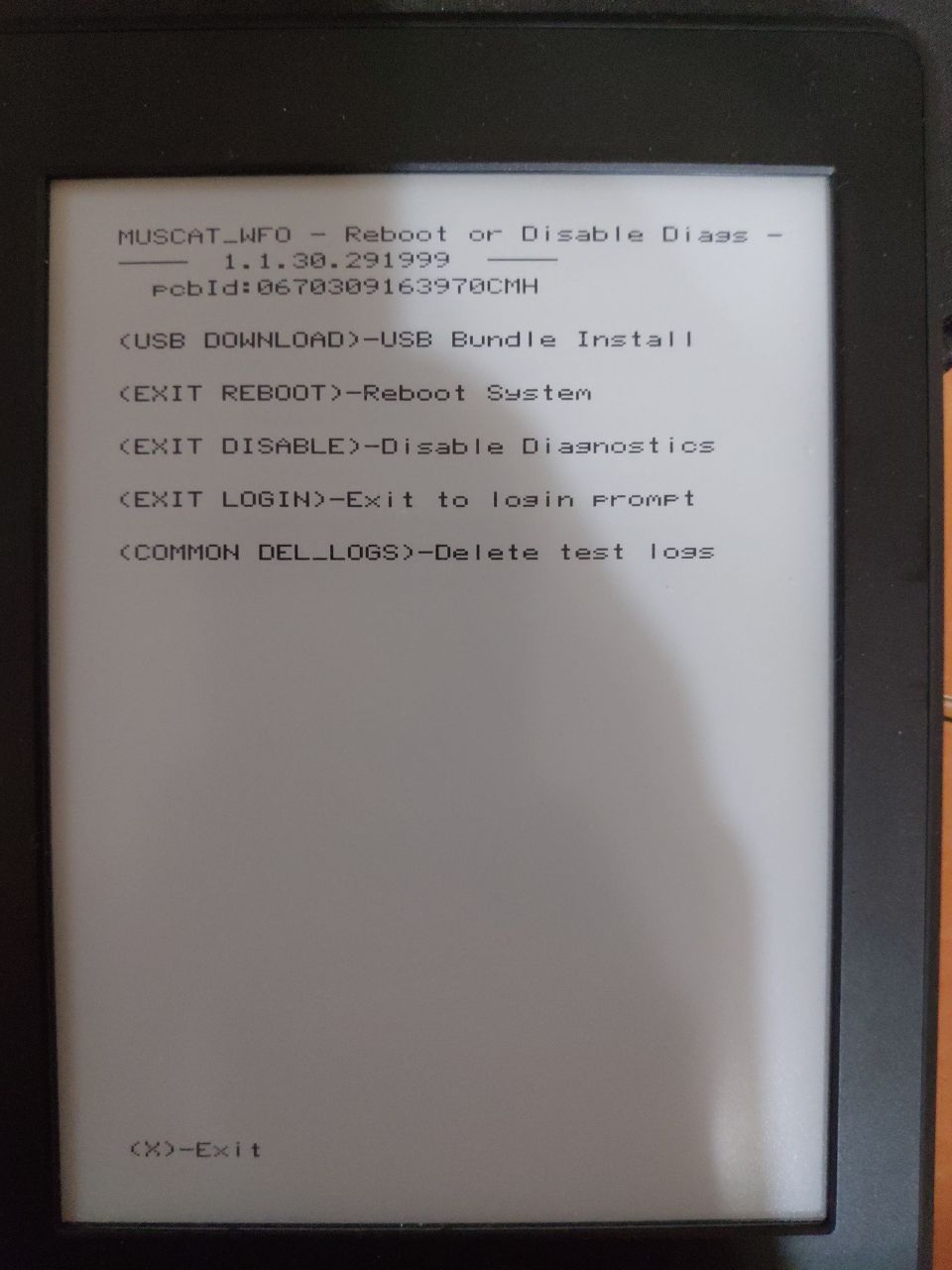

Thank you for answering,
I have already charged the device, when I restart the device from the interface the message is displayed on the screen:
Please use serial port.
Can I use USB Install Bundle to install a firmware version?

I dont remember the rest of the details on how to exit this.
@HarryT can this be moved to the dev forum?
Hello, everybody,
Thanks
That is the "Diags" system, not the "Main" system.
Leave on charger for a day or two (ignore the light color).
Remove from charger.
Use the "Exit Disable" entry.
Then use the "Reboot" entry.

True, if I fully charge the device and deactivate the diagnostic mode, it will work as usual.
Thank you very much, I was afraid to go out of the diagnosis mode and that it would not work anymore.
Cheers !!
