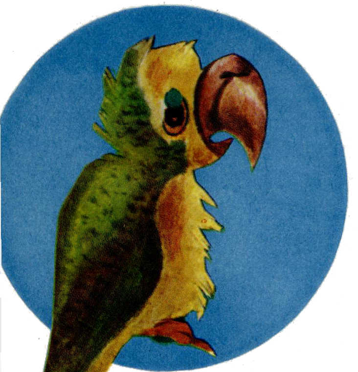

Hi
From time to time, I bump on these kinds of things. I'd like to find a practical solution for this one:
As you can see, It's a bird (head + tail) placed in the green area and standing on the left side of a page. My dream would be to know how to wrap the text around (intended light blue display).
I even cut the bird in two pieces and tried to stick the pieces together but I failed miserably (it worked for one font-size, but increase it and the tail goes away... )
Would somebody accept to publish here the relevant code?

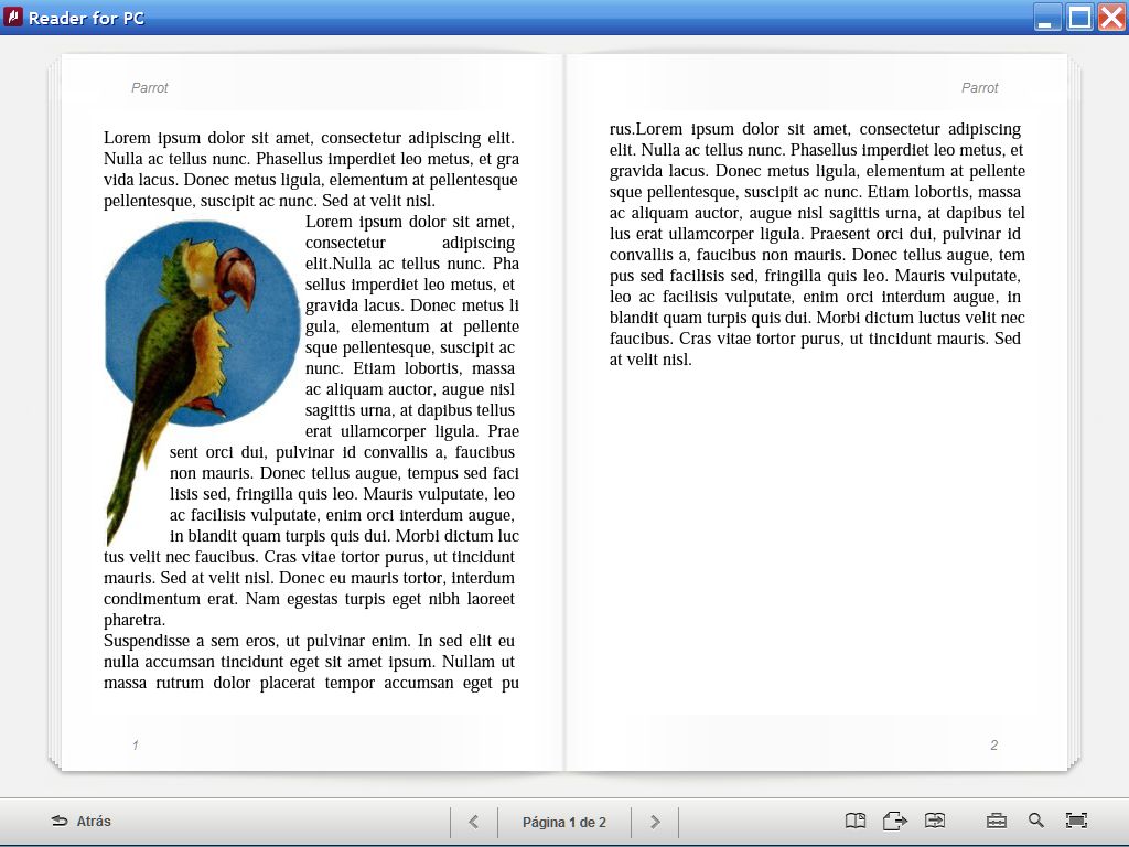

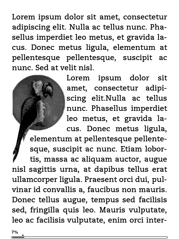

Something like this:?
https://www.mobileread.com/forums/att...1&d=1369173498
I made it with the following classes:
p {
  text-align: justify;
  margin: 0;
.parrot {
  background: url(../Images/bird.jpg) no-repeat top left;
  background-size: 183px 307px; /* the half of 366px and 614px*/
.box1 {
  float: left;
  top: 0;
  left: 0;
  width: 183px; /* the half of the original width: 366px;*/
  height: 195px; /* the half of the original height: 390px; (for the square section of the img */
.box2 {
  clear: left;
  float: left;
  top: 0;
  left: 0;
  width: 60px; /*120px;*/
  height: 100px; /*200px;*/
In the .xhtml file the text goes in the following way:
<p>...something...</p>
<div class="parrot">
<p class="box1"></p>
<p class="box2"></p>
</div>
Maybe that code can help you.
Regards
Rubén

Old 05-21-2013, 07:19 PM   #10
mrmikel
Color me gone
mrmikel ought to be getting tired of karma fortunes by now.mrmikel ought to be getting tired of karma fortunes by now.mrmikel ought to be getting tired of karma fortunes by now.mrmikel ought to be getting tired of karma fortunes by now.mrmikel ought to be getting tired of karma fortunes by now.mrmikel ought to be getting tired of karma fortunes by now.mrmikel ought to be getting tired of karma fortunes by now.mrmikel ought to be getting tired of karma fortunes by now.mrmikel ought to be getting tired of karma fortunes by now.mrmikel ought to be getting tired of karma fortunes by now.mrmikel ought to be getting tired of karma fortunes by now.
Posts: 2,089
Karma: 1445295
Location: Central Oregon Coast
Device: PRS-300
This is what happens in the Sony Reader Library.
It bleeds over.

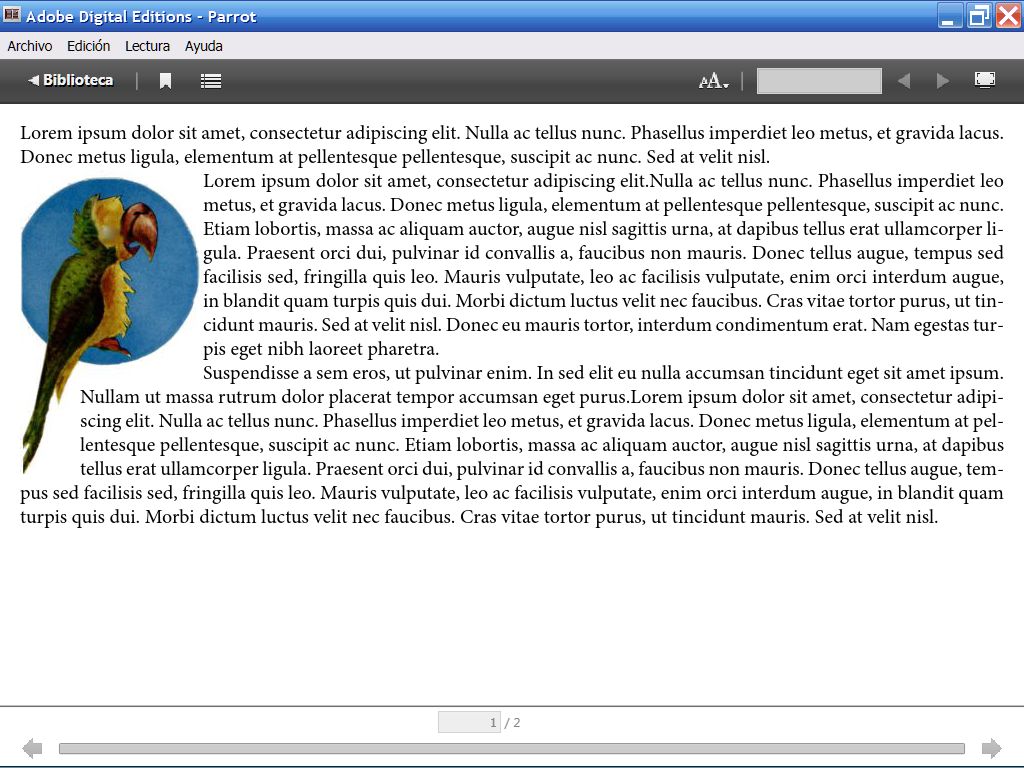

Old 05-21-2013, 09:03 PM   #14
RbnJrg
Posts: 1,881
Karma: 8821117
Join Date: Mar 2013
Device: Kindle 4 NT
It does not work in ADE 1.7.2 or ADE 2.0.
Hi JSWolf;
After resizing manually the original image before using in the .epub (see my last version of it), I got the following result in ADE 2.0.67532. So the solution is to use an image of the desired size and not to use css in order to resize it (in Kindle works with any size of image).
Old 05-22-2013, 02:55 AM   #15
roger64
Posts: 2,625
Karma: 3120635
Device: Kindle PW3 (wifi)
@RbnJrg
Hi Jorge
Thanks so much for your help. I have really spent hours trying to do it and had given up. Your EPUB looks good. I will study it closely and look how it displays on Kobo and later how it goes to PDF with Prince.
ADE is OK. Prince too. The only thing, Kobo does not agree (text mixes with image), but Kobo is backward on so many fields with formatting, I find it hardly surprising.
The code cannot be more compact and clearer. Use of background, background-size (I noted for this one to be careful) and boxes is really very convenient.
