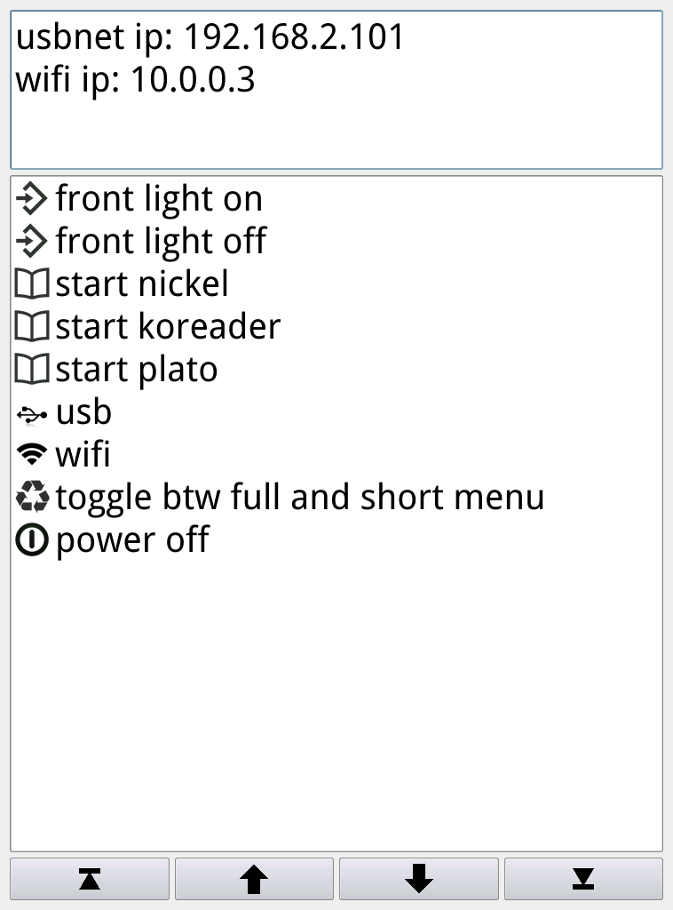

One new feature of KSM 09 is how it behaves at start up (by default):
  • It starts a server and provides access to the device via a webinterface. This is an attempt to give the user some control over the device, when difficulties arise, for instance spontaneous screen rotations, unresponsiveness to touch, broken screen.
  • It enables USBnet in order to allow sending requests to the server.
  • It enables wifi in order to allow sending requests to the server, when USBnet for some reasons cannot be used.
  • When there was no request sent to the server during the first minute after start, the server shuts down and USBnet will be disabled. (Note that you have to take care of wifi yourself.)
  • There are options to prevent wifi, usbnet, and the server from being enabled at start up. You can also prevent control over the device via wifi, even when the server is running.
  • If you are interested have a look at Playing with the KSM 09 webinterface

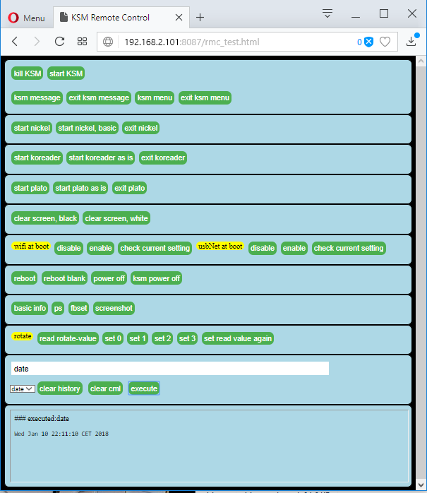

Webinterface:
With the default configuration, you have about one minute to connect to the reader by webinterface. Note that wifi is switched off as soon as nickel starts. For the moment it might be best to test whether you can connect, but do not yet try the offered commands (I will give some explanations later.)
To connect to your device type http://{The ip of your device}:8087/rmc_test.html into the navigation bar of your browser and press enter.
In the case of USBNet the line is: http://192.168.2.101:8087/rmc_test.html.
In the case of wifi, the line is something like: http://10.0.0.3:8087/rmc_test.html.
ID:	161420   Click image for larger version
