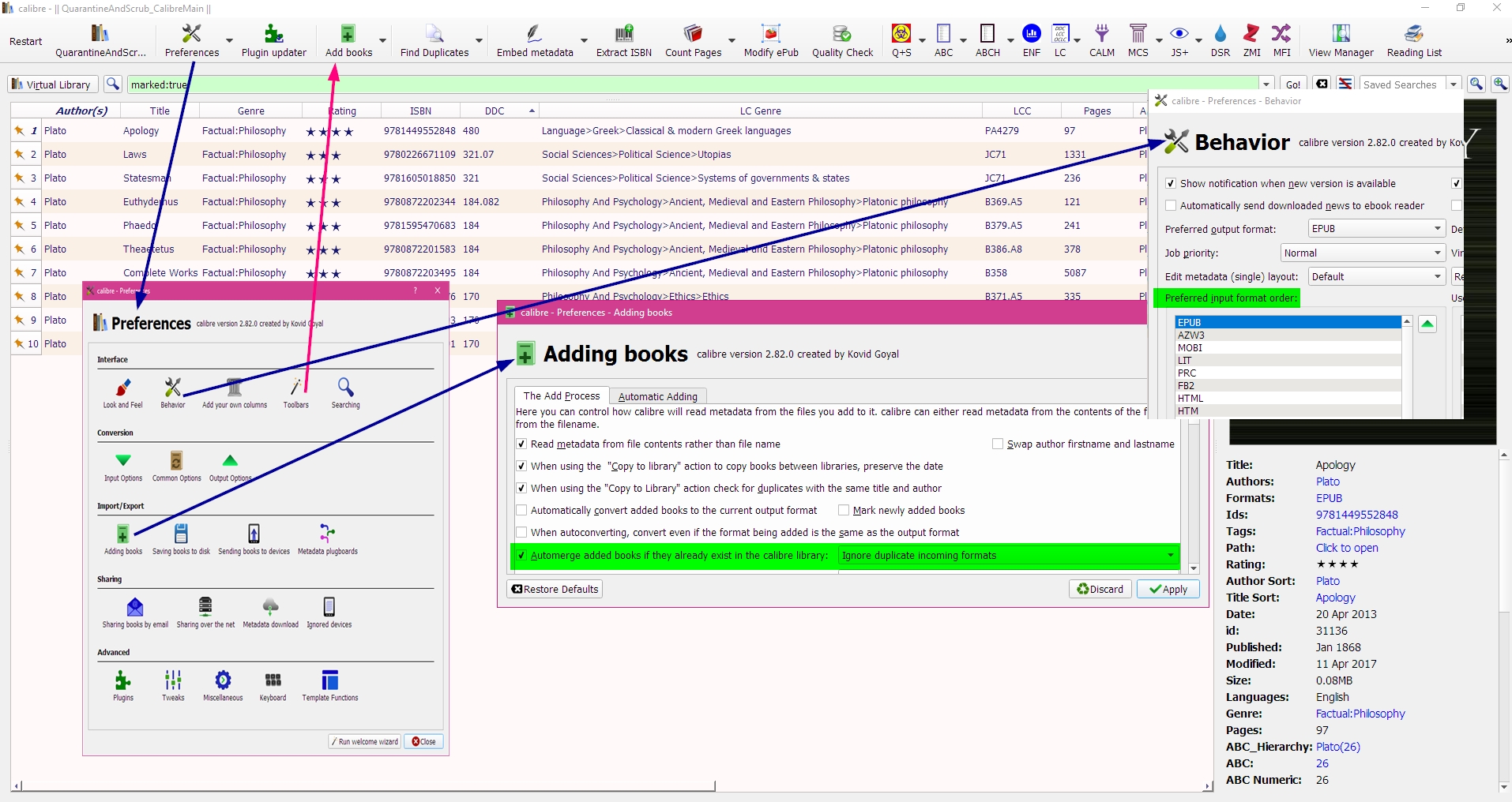

You need to start over from the beginning with Calibre.
[1] Create a fresh, new, empty Calibre Library, and switch to it.
[2] Configure Calibre. See the attached image.
[3] Start using the "Add Books" button that you placed on your ToolBar in Step 2, above. Do not ever use Windows Explorer to add, change or delete books.
[4] When you Add Books, and Calibre tells you that it found duplicates, choose wisely as to what Calibre should do or not do.
I suggest that you first add a few small samples of your 4,000+ books so you can test-and-tune your Preferences to suit your needs.
Adding 4,000+ books might take a few hours depending on your computer system, so add them in reasonably sized chunks.
It would be a good idea to read the Calibre User Manual found at https://manual.calibre-ebook.com/
